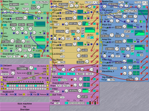

Kick machine:
Note that as sometimes you may want the envelope click in the sound, use the BeaterOsc for that part of the sound and set the filters so that the HPF is before the amp envelope. As such, not all the parts of the sounds I created are in their 'pre-labelled' postions, ie. the bass may be from the vibration path because I wanted to use something from that path not in the bass path. (See below for attached screenshot)

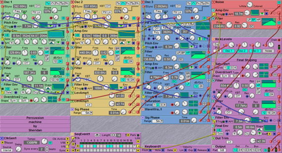

Percussion machine:
Cowbells, rimshots, bongos, etc. Again, it turns out that percussion is quite tricky for the beginner (me included) to recreate. Check out SOS for help (see main text). Note that as Osc 2 was designed to reproduce vibrations, ie. a narrow band of thick partials, it has 2 Lev Amps to increase it's filtered-down level.
Screenshot of the Kick machine patch.
 Filesize:  224.94 KB
 Viewed:  16344 Time(s)
Screenshot of the Percussion machine patch.
 Filesize:  137.44 KB
 Viewed:  16342 Time(s)

I think the kick machine here is well done. Very nice actually. Cool
The snare too is nice as is the percussion machine.

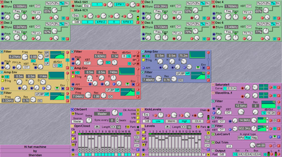

Funny that you're all talking about hi hats... because here's my 'Hi hat machine'! It has two methods of creating the many enharmonic partials needed: the six square wave method mentioned above or 3 part FM - Note that when using FM, turn off Oscs 1, 3 and 5 as shown in some variations. There are three seperate audio paths, each with filtering and envelopes plus the usual final shaping modules.
I have been a bit lazy with the 6 square wave setup (only 1 set of variables) as it is a bit of a nightmare having to tune each one by ear and this set took me a while to find! I have as usual created 8 variations. I am very pleased with this patch and will surely be using these hats!
Note that there are two 'Level Sequencers': 1 is for decay (open/closed) the other is for level and is also connected to the filters.
Below is a screen shot.
Have fun!
Screenshot of the Hi hat machine patch.
 Filesize:  115.91 KB
 Viewed:  16234 Time(s)

Sweet !!!
Hey Sheridan , these are some of the best Hats ever, no joke!
Thanks Smile

Yeah thanks, I'm pretty impressed myself! Very Happy Add a touch of reverb and they're even better!!
Not bad for a modular noob! Cool
