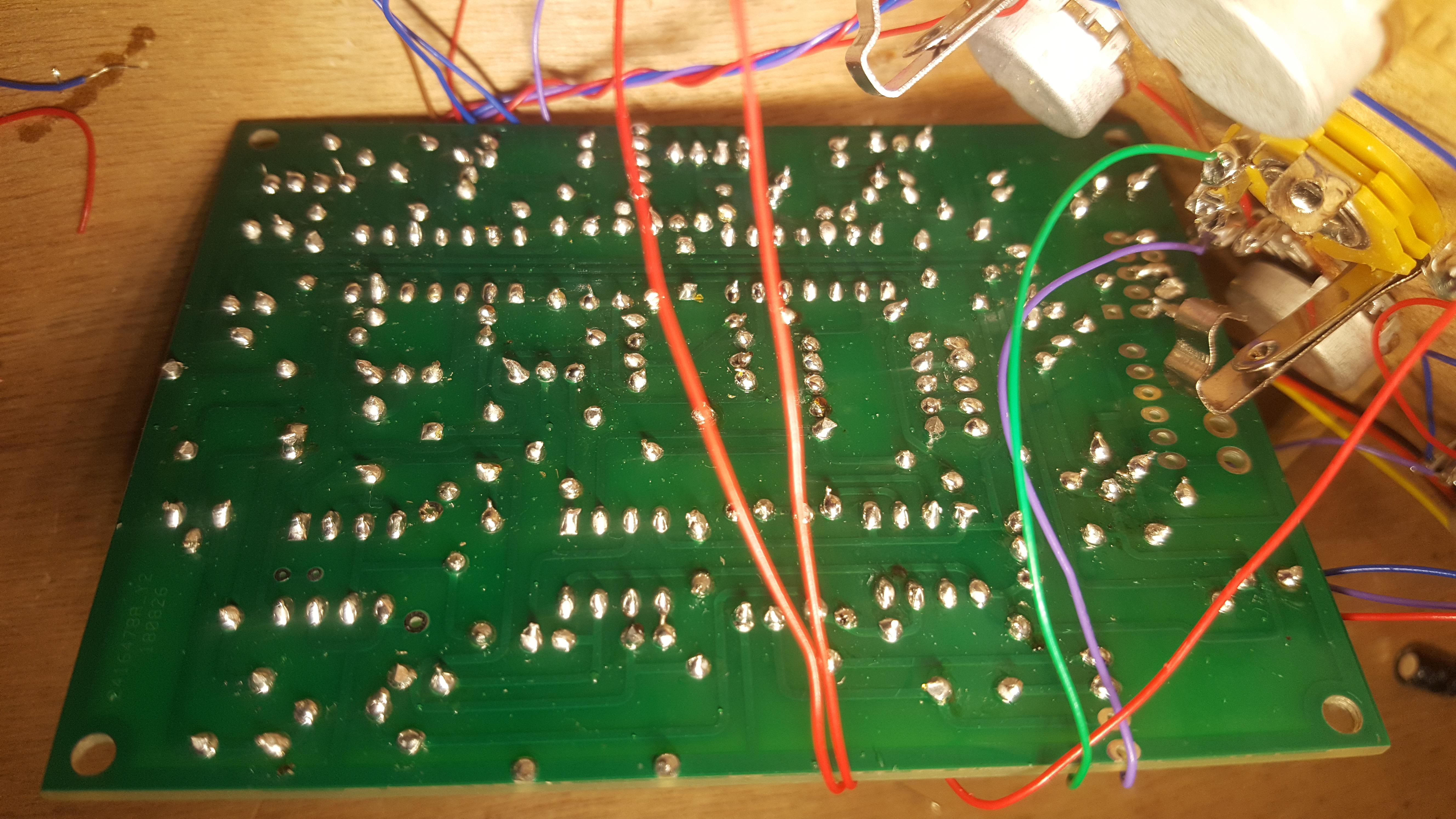

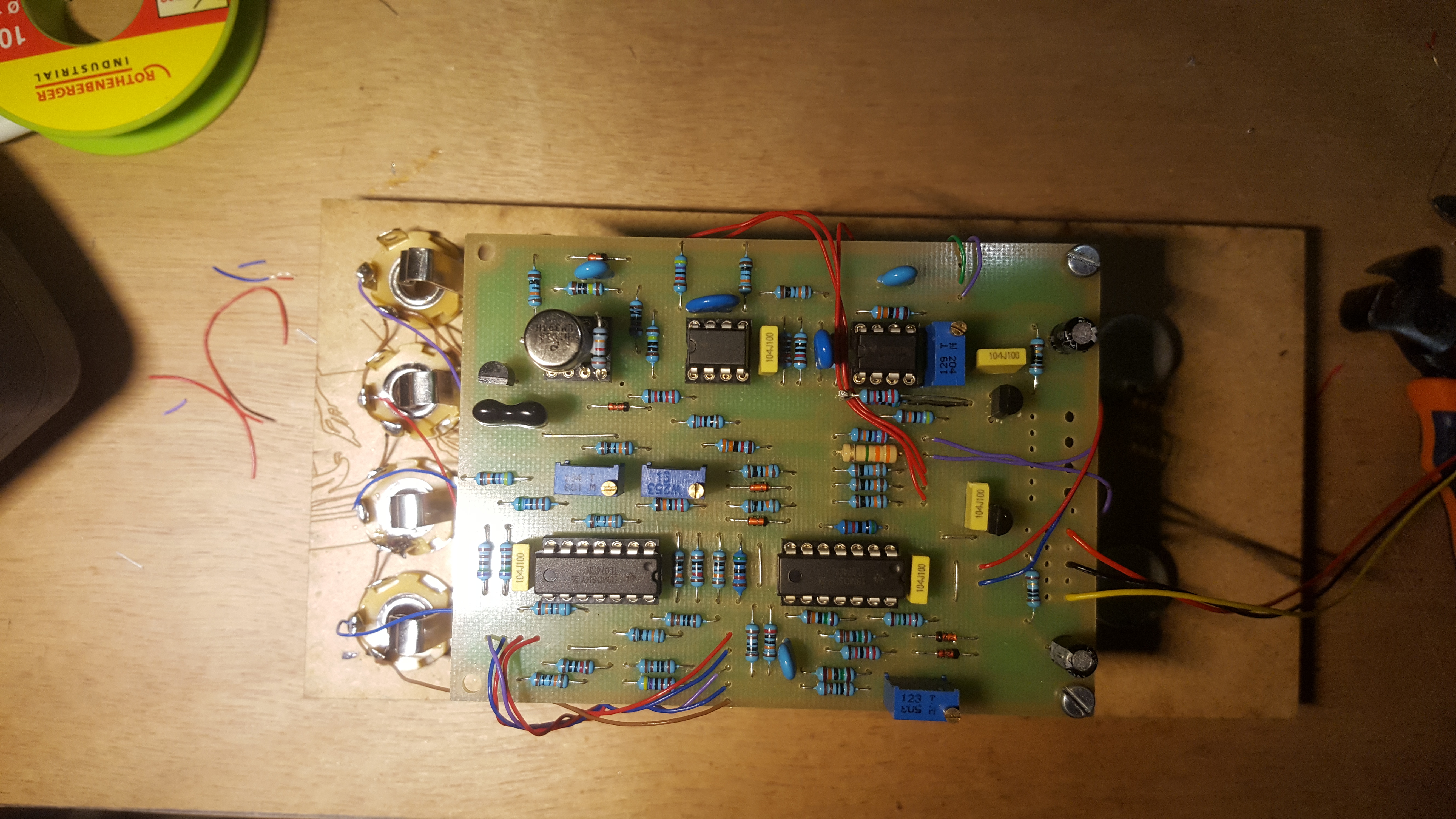

wackelpeter
Joined: May 05, 2013
Posts: 461
Location: germany
Audio files: 10
PostPosted: Fri Oct 19, 2018 2:01 pm    Post subject: Reply with quote  Mark this post and the followings unread
Maybe post some pics of your pcb and maybe write measurements you already made into the schematics and post it here too…
Do you have an oscilloscope?

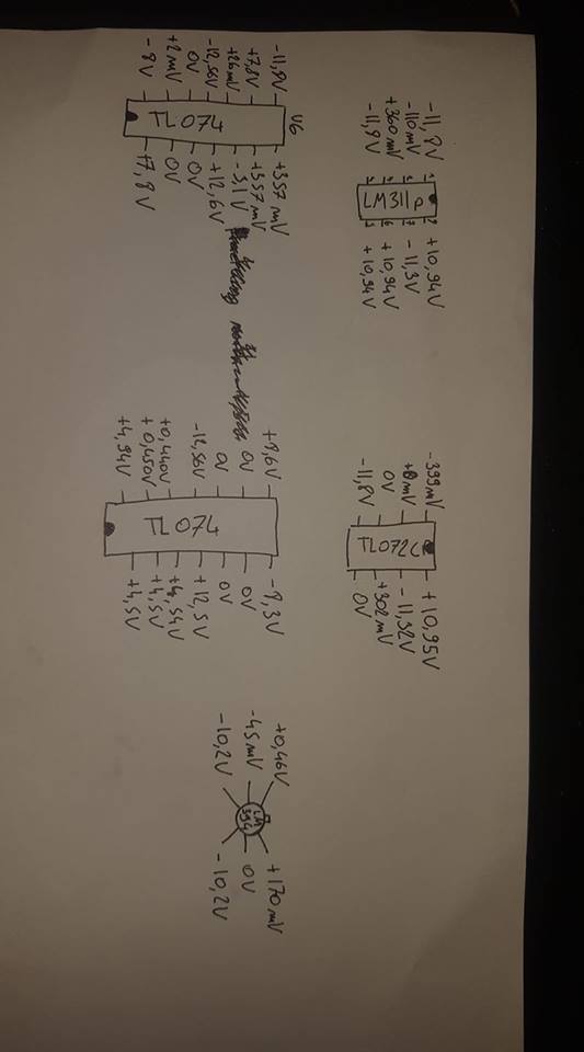

MrSbarre

PostPosted: Fri Oct 19, 2018 2:14 pm    Post subject: Reply with quote  Mark this post and the followings unread
Here are some pics of my PCB
 Filesize:  4.41 MB
 Viewed:  463 Time(s)
MrSbarre
Joined: Oct 18, 2018
Posts: 9
Location: Paris
PostPosted: Fri Oct 19, 2018 2:15 pm    Post subject: Reply with quote  Mark this post and the followings unread
 Filesize:  4.08 MB
 Viewed:  444 Time(s)

PostPosted: Sun Oct 21, 2018 6:46 am    Post subject: Reply with quote  Mark this post and the followings unread
Here are all the mesurement from all the ICs
 Filesize:  28.52 KB
 Viewed:  462 Time(s)
gabbagabi
Joined: Nov 29, 2008
Posts: 652
Location: Berlin by n8
PostPosted: Fri Oct 26, 2018 11:41 am    Post subject: Reply with quote  Mark this post and the followings unread
do u have a signal there?
if u have a static voltage there, is it changing if u move the freq-pots?
