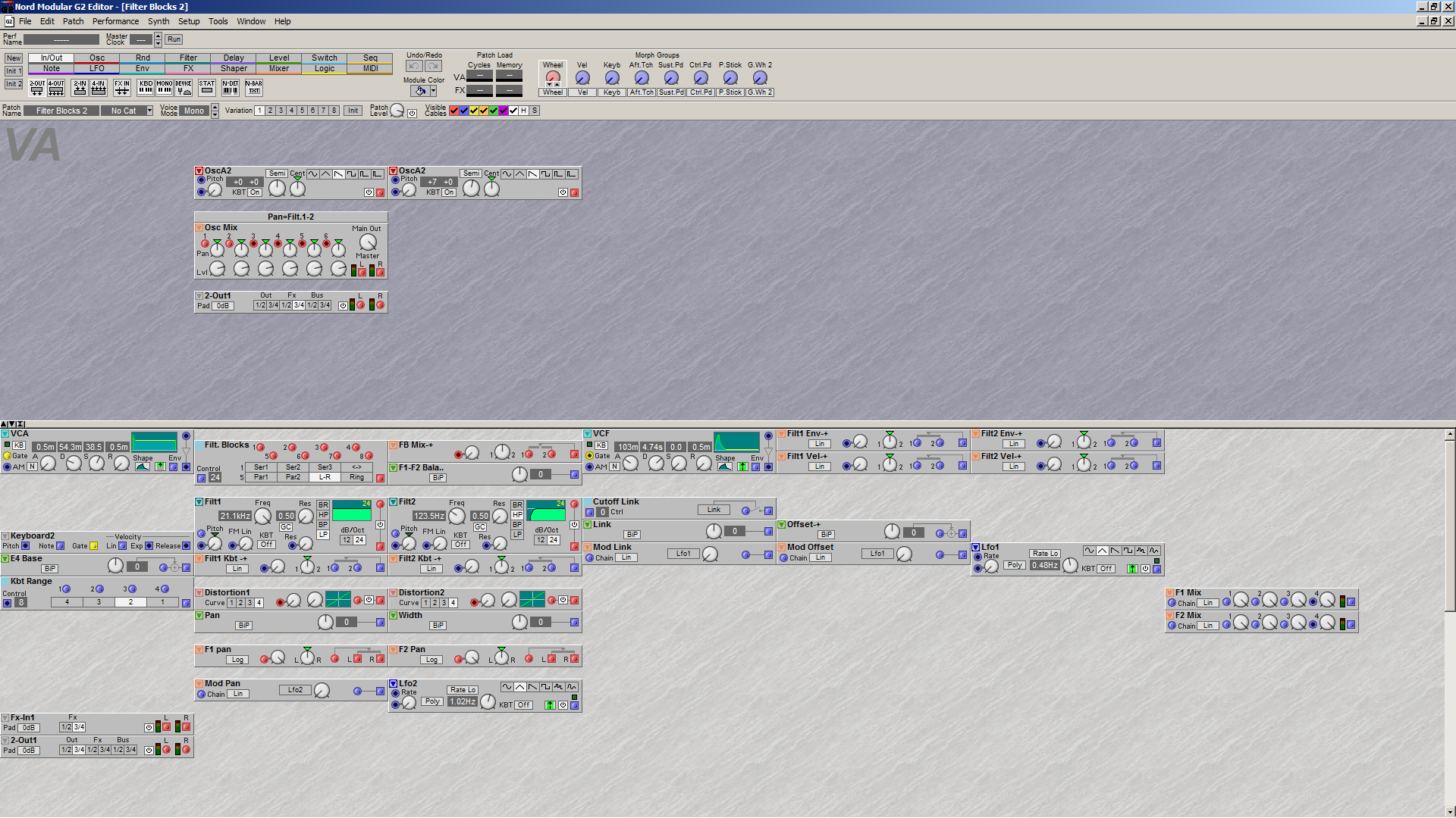

Hi.this is my first upload here and first i want to thank the users of electro-music for sharing their knowledge all those years!
This is a filter building block that is similar to Virus,Blofeld and Surge filters.Basically i liked the filter routings of Surge more because it offers more routings than the other two thus more possibilities.
There are eight filter blocks like in Surge which offer different feedback and distortion routings except block 1 that doesn't have feedback.
Extra stuff:
1)Positive-negative feedback modulation.
2)Filter kbt with positive - negative modulation,plus option to change the base note where the modulation starts.(by default base is E4)
3)Positive-negative modulation for filter envelope and velocity.
4)Filter link and offset-The first modulates both filters and the second is filter2 which acts as an offset.
5)Filter Balance where you can mix each filter.
6)Pan and width which is great for stereo effects and comes from surge.
*Width works only when you choose the L-R or <-> Block.
Because L-R is in parallel it works better and has more possibilities:
Combining with the pan knob can make nice stereo effects.
Also you can pan Filter 1 or 2 individually and change which filter goes to oscillators e.g osc1-filter1 , osc2-filter2 or any combination.
Cheers!
I hide the routings below to have more clean interface
