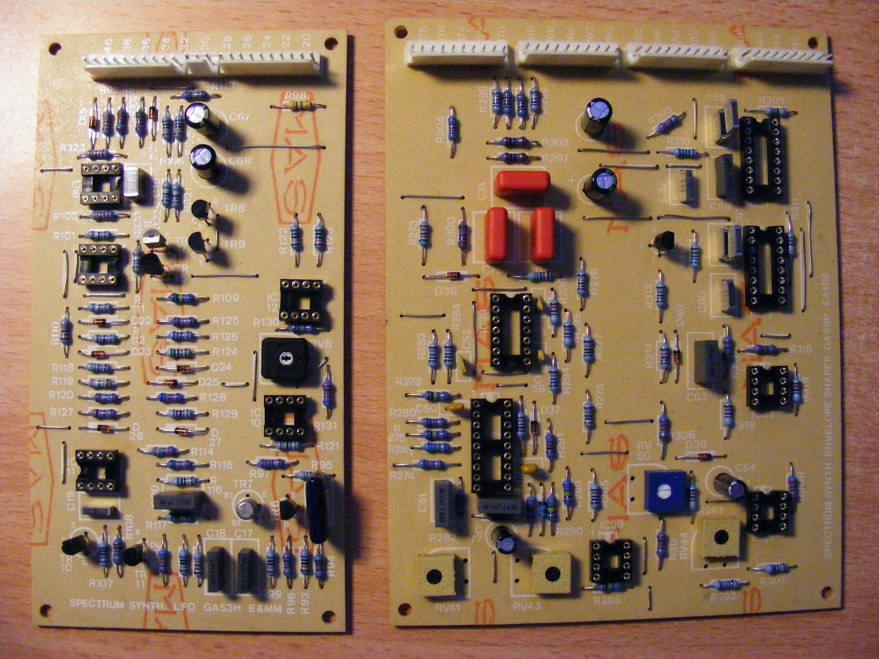

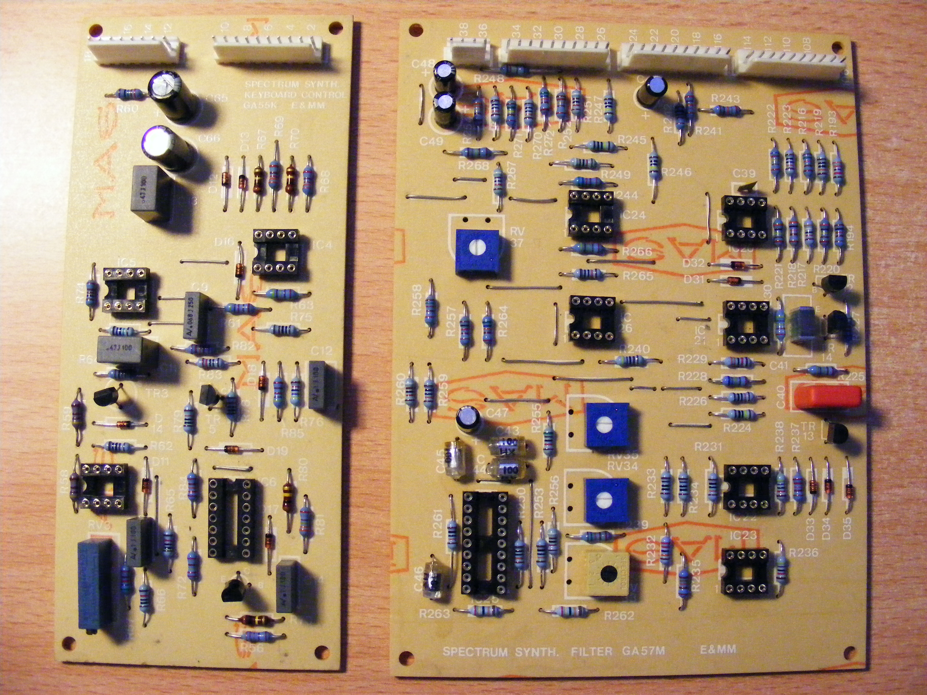

It's been a while since I mentioned this project and there has been quite a bit of progress in the last few months.
All of the PCB's have been stuffed, as in the photo's below.
I've also managed to source all of the chips, including a few spares of the elusive CEM chips, mostly via eBay.

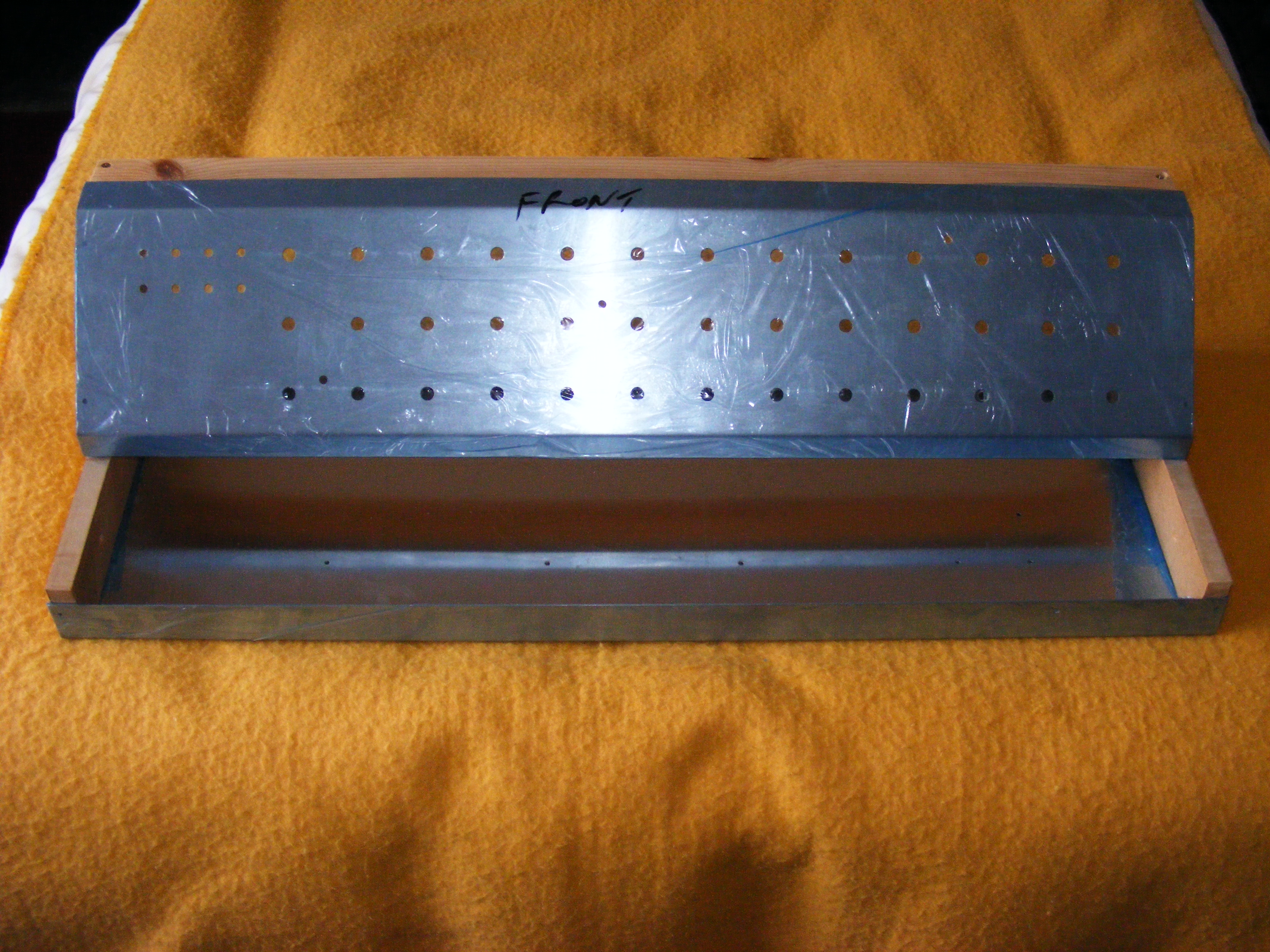

The best news though is that I have managed to find a local supplier (Ironically via eBay again) who has made the main metal panels for the synth, though I did have to re-learn some CAD to produce suitable AutoCAD compatible DXF files for this to work out. The three main panels worked out at 115 GBP including taxes - including supply of the metal and bending the panels.
There is still loads of work to do on this synth. Painting the panels to a good finish is important to me (and I'm still learning the lessons from previous rushed attempts) and it will no doubt be fun labeling up a panel that is 820mm wide to a good standard. Wiring is going to be fun (25 pots and 14 rotary switches) and I've also decided to use high quality pots for the panel now. Then the fun of testing and calibration.
Spectrum Keyboard Controller and VCF PCB's
 Filesize:  2.89 MB
 Viewed:  243 Time(s)
Spectrum LFO and ADSR PCB's
 Filesize:  2.96 MB
 Viewed:  249 Time(s)
Two of the main Spectrum Panels, temporarily mounted on their support frame.
 Filesize:  3.19 MB
 Viewed:  245 Time(s)
