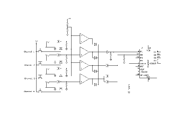

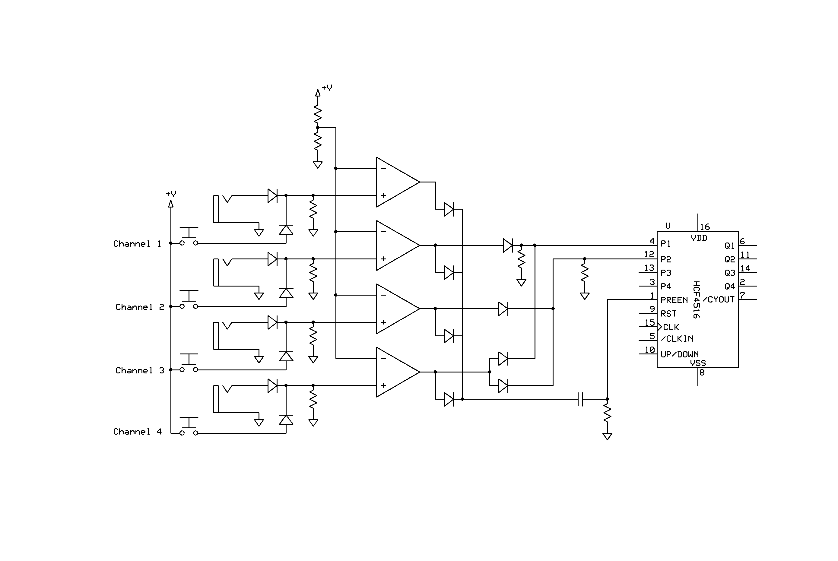

PostPosted: Sun Jan 11, 2009 4:16 pm    Post subject: Reply with quote  Mark this post and the followings unread
Playing the feature creep for a moment. Oh, hell, who's pretending? Very Happy
Why use that counter? The CD4516 was built to make stuff like this much more versatile.
I know you said "simple", but it wouldn't take a whole lot of surgery to make this really kick.
A CD4516 would allow you to count up and count down. You could also jam an input in, so you wouldn't have to work sequentially. Each channel could have its own momentary - you could jump from channel 2 to channel 4, for example, or 3 to 2, just by pushing the associated switch. Creeping forward from that, each channel could have its own pulse input so you could automate that process. Forward/reverse could be a switch.
I'd use a diode matrix for the momentary inputs for the jamming, but you could use a priority encoder, too, which is, of course, another IC.
Back under the rock....
Cheerios,
Scott
My Site
Scott Stites
Joined: Dec 23, 2005
Posts: 4127
Location: Mount Hope, KS USA
Audio files: 96
PostPosted: Sun Jan 11, 2009 5:08 pm    Post subject: Reply with quote  Mark this post and the followings unread
Here's what I'm thinking about - it's a rough draft of the concept. Dunno if it works exactly as drawn (capacitor value might need played with) and debouncing would need to be addressed. I think reverse would be gilding the lily, but individual selection would be great - you could pre-patch stuff and select among things. Especially the way you patch up things like that (I'm thinking of those Klee videos and samples).

PostPosted: Sun Jan 11, 2009 5:55 pm    Post subject: Reply with quote  Mark this post and the followings unread
Here's an implementation that would allow external signals to select any of the four channels arbitrarily.
 Filesize:  20.89 KB
 Viewed:  289 Time(s)
My Site
PostPosted: Mon Jan 12, 2009 10:13 am    Post subject: Reply with quote  Mark this post and the followings unread
scott, you are driving me crazy! first i had an idea how to do something i want - then do you taking this far beyond with such nice ideas, and now i am thinking of how to use this for my synth Shocked
Laughing
honestly a great idea. i will see how this fits in my UI concept (big words Embarassed ).
