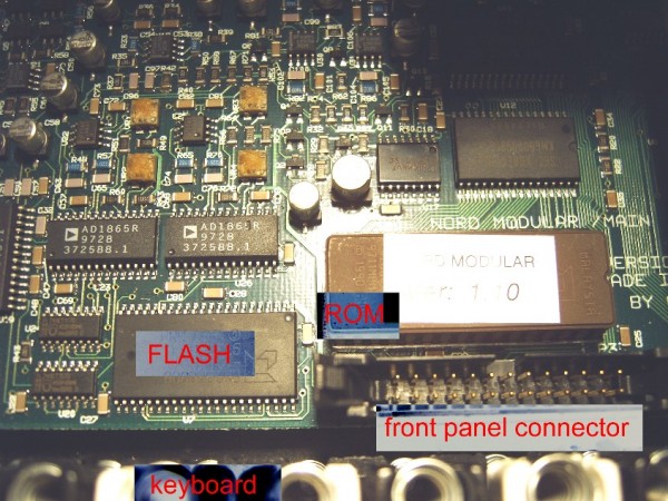

This mail was sent to me in private.
Wout
Hello,
My name is Anton and I am emailing from New Orleans. I decided to ask this particular question(s).
I have a Nord Modular Keyboard (second hand) for about a year. Since the beginning it has been glitchy.
When I first started using it, it would only play most of the patches fully. Many others it would not access. Then, it started to play those patches it would allow, but after several minutes it would not play any of the patches.
The remedy, at least for some time, was to turn it off and on and I could access the patches again. But, it would reoccur and it would allow less time for every subsequent shutting off and on. Eventually, it would not play any patches. I would let it sit for a few days come back and the same scenerio would play itself out again.
I began to expect that it just may be a battery problem. I opened it up and looked for the battery. Lo and behold, I am not exactly sure which component is the battery. There is a sliver type of cylinder strapped to another component on the board and I believe it to be the battery. But, I am not sure. It can use the Nord Modular Keyboard as a Midi Controller even with the situation above. It never loses power.
So, here is my question: Do you know which component is the battery? Have you encountered this problem with the Nord Modular? If you do not think it is this, do you have any suggestions?
I would appreciate any information you could share. I am in New Orleans and there is no one competent enough to fix a Nord Modular. If it is the battery, then I feel comfortable enough doing it myself.
I really loved using this keyboard and would love to continue using it.
Thanks for your time and help! Look forward to hearing from you!
Anton!
Posts: 24446
Audio files: 297
PostPosted: Sun Dec 03, 2006 5:32 pm    Post subject: Reply with quote  Mark this post and the followings unread
I'm affraid I have bad news for Anton.
To my best knowledge there is no battery in the NM Classic, to be sure I just opened it up and did find a silvery cylinder, but that is an electrlytic capacitor on the power supply board. I found nothing looking like a battery.
There have been more reports like this one lately about the NM Classic, and it looks like the internal flash memory (used for patch storage) is becoming defective - a thing that can happen when they are heavily used depending on some environment factors as well.
If this is true (I can't guarantee it to be true, but I believe it is) the only solution would be to replace the bad chip. For someone not having experience with this this is not a DIY project, but it is something that can be done (although there is some risk of damaging the main board with this operation, and that would make it harder or near impossible to get it working again).

PostPosted: Mon Dec 04, 2006 5:52 pm    Post subject: Nord Modular Keyboard
Subject description: Flash Memory not Battery
Rolling Eyes
Hello Yall!
Thanks for the replies! I think the flash memory thing is probably it. It will only show a blank screen now and will not load any of the patches. I think yall hit it on the nailhead.
Now, I have to figure out how to get it fixed. I have loads of people I know who really do extensive fixes on computers, so I think they would be capable of desoldering and resoldering the chip.
Do any of you know exactly where that chip is set, so I can get it done? Even if I do that I wonder if I can get the chip!
Any help would be great.

PostPosted: Mon Dec 04, 2006 6:22 pm    Post subject: Reply with quote  Mark this post and the followings unread
Hi Anton, welcome.
I've just reopened the thing and was about to take some pics ... batteries empty ... charging now Smile
Posts: 24446
Audio files: 297
PostPosted: Mon Dec 04, 2006 7:11 pm    Post subject: Reply with quote  Mark this post and the followings unread
Charged enough. I loosened the front panel flat cable connector so a bit more can be seen. The flash in my NM is an AM29F080B - made by AMD.
Hope it's all clear this way.
NM Classic internal detail around flash device
 Filesize:  209.07 KB
 Viewed:  256 Time(s)
PhaseChange
Joined: Dec 04, 2006
Posts: 6
Location: New Orleans
PostPosted: Mon Dec 04, 2006 8:10 pm    Post subject:  Nord Modular Keyboard
Subject description: Flash Memory not Battery Part II
Hello again,
Thank you very much! I have to give it to yall! Yall are a great forum to be part of--definately so!
I really appreciate the photo and the work! Bravo!!!
Ok, now I can get to work on the next step: getting the Flash replaced and having the Nord Modular Keyboard up and running again.
