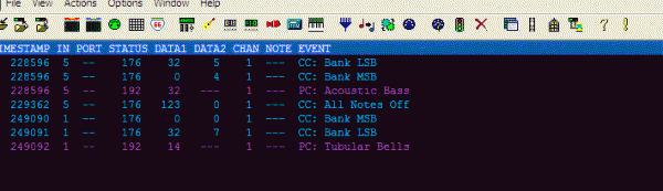

The problem is the order in which Ableton sends the Banch change LSB, MSB
Ableton sends
CC30 LSB
CC0 MSB
PCH
G2 sends/recieves
CC0 MSB
CC30 LSB
PCH
It looks like the G2 must recieve the MSB first. It also looks like this may be the way the messages should be sent. Here are 2 examples.
1st 3 lines - Ableton
last 3 lines - G2
 Filesize:  9.84 KB
 Viewed:  326 Time(s)

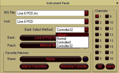

OK I think it's clear...
If you look at this picture (MIDI-OX http://www.midiox.com/ ) you can see that for each instruments you can choose between 3 different methods for bank changes:
1:Normal (I think this is workin' as a pair, the Ableton way)
2:Controller 0
3:Controller 32 ( THE CLAVIA way )
So every soft that want to be called a GOOD midi sequencer MUST have this feature.
PS:I AM IN LOVE WITH MY NORD MODULAR Embarassed
 Filesize:  24.77 KB
 Viewed:  11603 Time(s)
