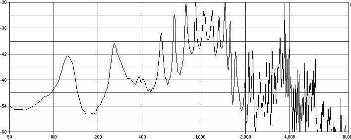

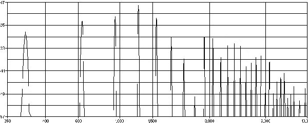

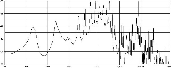

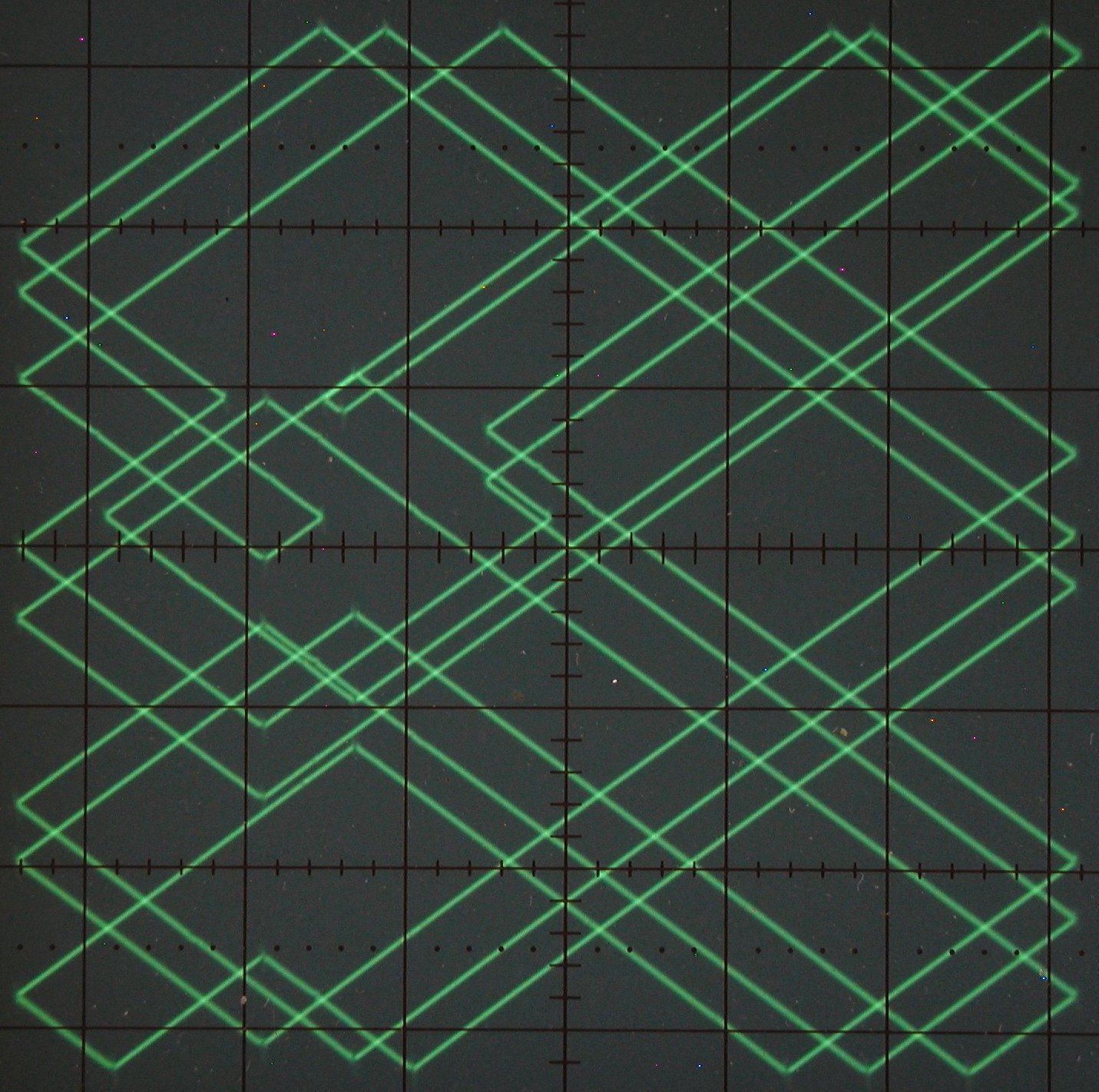

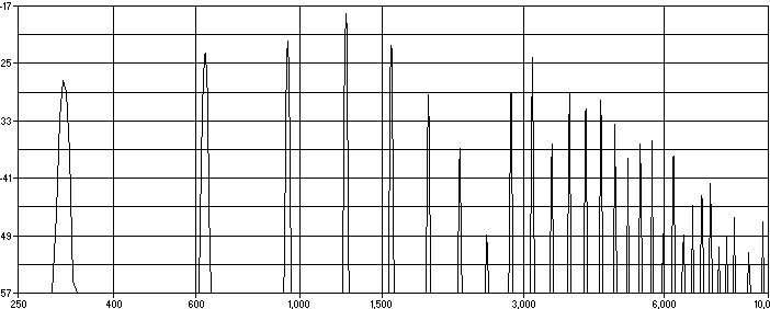

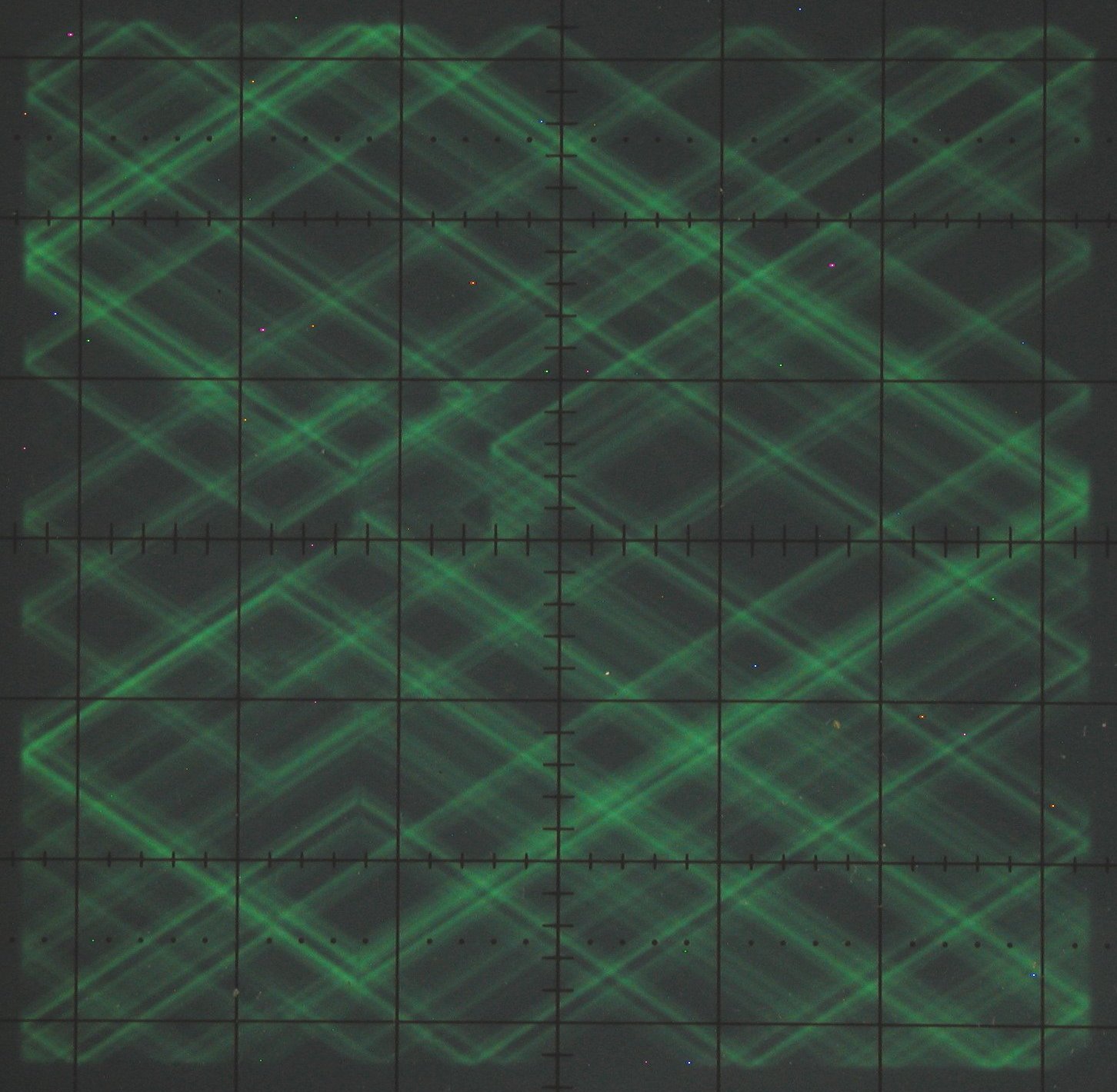

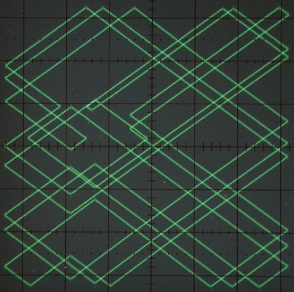

So ... if you feed two Tri waves into your scope and look at the xy display (Lisajou figure) you see what looks like a ball bouncing around a billiard table. This makes sense, because the ball has constant speed in the x and y directions corresponding to the constant positive and negative slopes of the two waves.
In mathematical dynamics there is a class of problems called "billiards" related to billiard balls bouncing around tables (which may have a variety of shapes). The tables may also have objects placed on them (again, with a variety of shapes), so the ball bounces off both the table boundaries and these objects.
These billiard trajectories have unusual and interesting properties. For example, a square table with a square obstacle aligned with the table has some trajectories that are periodic (i.e., retrace themselves repeatedly), or quasiperiodic, and some that are highly irregular. The irregularity is often called "pseudo chaos", meaning that it seems as irregular as in chaotic systems, although the system does not satisfy the usual mathematical criteria for chaos.
Getting back to the two Tri oscillators, it is quite easy to electronically simulate an object on the table by using a bunch of comparators and a means of reversing the direction of the oscillators at any time. A familiar oscillator is the Tri VCO based on comparators and an RS flip-flop, such as in the Electronotes TZFM VCO that a number of folks here have built.
So I set up circuit like this, with trajectories modified when the "ball" is in certain regions. (These are not true physical reflections, but never mind, the idea is the same.) Here are some results:
Figure 1 is a scope shot of a trajectory that is periodic, with many trips around the system before repeating. Figure 2 is a photo of a nearby trajectory that shows the irregular behavior of pseudo chaos. This is seen in the areas that look like bands, where the trajectories densely fill the areas.
Figures 3 and 4 show the frequency spectra of the two trajectories. The pseudo chaotic one has a broad and quite strong background feature, just like seen in spectra of the more familiar chaotic systems. The periodic one has many strong overtones.
Finally, the mp3 has two sections, corresponding to the photos, so you can hear what pseudo chaos sounds like.
I'll try to post some more examples later, if anyone is interested.
Ian
Edit: Computer simulations seem to indicate that the trajectories in this system are periodic, often with many thousands of bounces per period. The irregularities seen above are probably related to noise in the system modulating the path in a discontinuous manner. Still pretty interesting, though!
Figure 1
 Filesize:  362.2 KB
 Viewed:  737 Time(s)
Figure 2
 Filesize:  258.64 KB
 Viewed:  731 Time(s)
Figure 3
 Filesize:  39.21 KB
 Viewed:  742 Time(s)
Figure 4
 Filesize:  43.01 KB
 Viewed:  717 Time(s)

PostPosted: Fri Apr 02, 2010 9:56 am    Post subject: Reply with quote  Mark this post and the followings unread
Uncle Krunkus wrote:
I'm thinking a couple of window comparators on two triangle or sawtooth generators, then use boolean operations on the comparator outputs to determine whether one or both waves get inverted. Is that close?
Yes, that's it exactly! thumleft
There are two Tri VCOs, similar to the EN TZ VCO, which I believe is available at Bernie's website. These are based on a CD4013 RS flipflop chip. When the signal reaches either 6V or 0V (the "walls" of the table) R or S reverses the ramp in the usual way. In addition, a pulse on the Clock line will also reverse the wave at any time (upon hitting an "object").
The "objects" are colums or pillars extending out from the walls. Each is defined by a window comparator (presently one of the output stages of an LM3914 bargraph chip) to determine the base of the pillar and another (single) comparator to determine the height. There are two pillars, one extending up from the x axis to an adjustable height y_h. The other pillar extends to the right from the y axis.
When the ball crosses into one of the pillars, one of the oscillators is reversed, depending on how the subsystems are jumpered together. For example, if the pillar extending up from the x axis is entered and the x oscillator is reversed, then it looks like the wave is reflected from the sides of the pillar, unless the pillar is entered from the top, when the reversal is the same but it doesn't actually correspond to a reflection.
If the y oscillator were reversed instead (as in the scope shots) then the wave reflects if it hits the top of the pillar, but bends if it enters the side of the pillar. You can see the pillars in the scope shots as the places where the wave direction changes inside the square.
Yes, I'll try to get some diagrams made up at some point.
My original goal was to make a 3D system, with z reversing when the xy pillar is entered and similar for the other coordinate permutations. (I've never seen any studies of 3D billiards.) But my whiteboard is already full. Sad
Anyway, the present system is much richer in complexity than I expected, so I think a simpler system might be just as good. I'll post a clip with one of the oscillators being swept so you can see how complex the system is.
Ian
