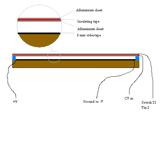

Just a pic of the idea;
this sould be the simpliest way to build a CV-gate controller.I've read somewhere that 8mm video tape is a good resistor so we can use this like a potentiometer for a home made CV controller (watch the pic)
From the original schematics we can see that S1 is connected to ground when pressed.Probably (don't do it until we are shure of this!) touching Pin 2 of S1 we can put to ground it!
OK the picture is more esplicative.
Important: maybe there are some problems with static electricity(the same that could burn ICs) .We can avoid this using a zener diode protection like that used for CV inputs.
Please tell me if it could be danger (or useless) for the SL.

on the web i have seen these ribbon controller instructions:
and more advanced:
but there is no gate option on these but your "touch the ground" - idea will be perfect to generate the gate. so if we combine these whit your design i think it will work on SL whit out frying it. but in any case the 9.1V zener is not a bad idea at all to protect SL CV inputs

The Simpliest idea for the single bus keyboard (With any else but the bus, resistors and switches ) is to put two switches for each key or a dpst switch for each key.One is for CV the other simply put to ground the pin 2 of S1.
In this way will be lost portamento legato ... ,but I think that this is the simpliest and better way to build a keyboard controller.

if you have some lying around anti-static bags work ( ive found all the ones with low enough resistance are genrally black ones )

To further the point about anti-static bags, its the ones that are a black non-seethrough plastic that are best, NOT the silvery see-thro ones.
EDIT: To further my further point, the black bags are matt in appearance. You should know exactly what i'm talking about now. Razz

touching pin2 of S1 we will not put this point to ground directly,but via a 50k-200k resistor (this is the typical resistance of an human body).I don't know what this really implies but I think that in this way we don't put to 0V pin2.(Is this true?)
One suggestion may be a glove with a piece of conductive material glued on the top of a finger,connected directly to the SL ground.
maybe it isn't a powerful and free control but it's so '80s !

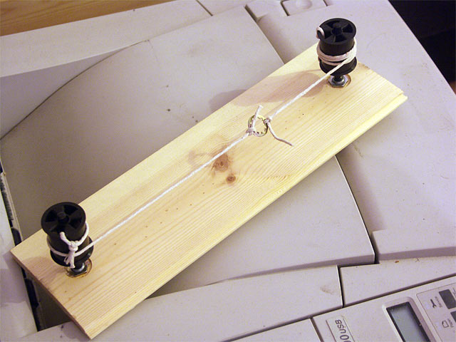

The ribbon controller is a nice idea, but how about a cheapo Ondes Martenot manual? Ideally this should be made with wire (for the tension needed), but I used some string, just to demonstrate the point (unfortunately string is crap- so it doesen't work very well as it stands here!!).
I reckon this could work well with 10 or more multi-turn pots (as there just aint enough travel on these shitty pots). One could also write a scale on (in this case a floorboard off-cut) the wood for easy playing.
There are also 2 pots. One is a dummy. Notice the cotton reels! (ingenious eh?;). These are held to the pot shafts with rubber-bands.
Next I will make a wobbly keyboard!! -But not until I finally finish my SoundLab which is taking ages.
Food for thought anyway.

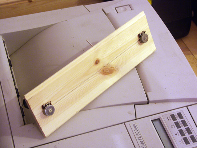

.....and the underside.....

What keeps the tension?
v-un-v
Joined: May 16, 2005
Posts: 8932
PostPosted: Sun Sep 11, 2005 10:09 am    Post subject: Reply with quote  Mark this post and the followings unread
well that's it. I was hoping that someone would shed a bit of light on this ;) The string holds no tension but I thought copper wire may be a better option. What are your thoughts?
Tom :)
v-un-v
Posts: 8932
PostPosted: Sun Sep 11, 2005 10:14 am    Post subject: Reply with quote  Mark this post and the followings unread
a continuous loop? that would do it- wouldn't it?
Macaba
Joined: Jul 13, 2005
Posts: 160
PostPosted: Sun Sep 11, 2005 10:22 am    Post subject: Reply with quote  Mark this post and the followings unread
Loop is the best idea, with a return line basically.
