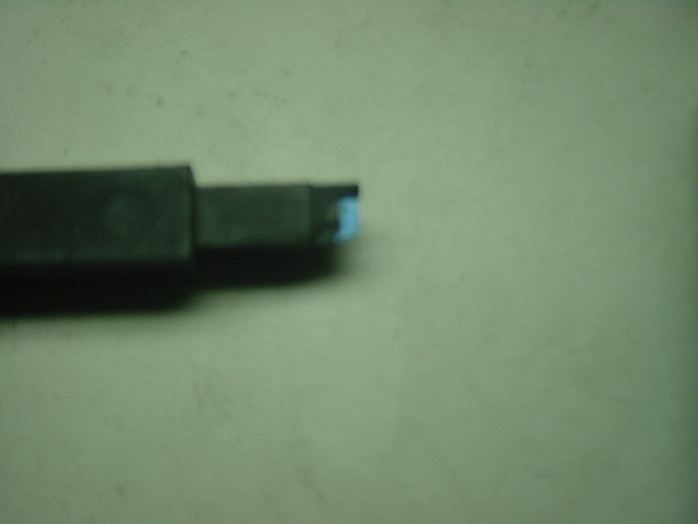

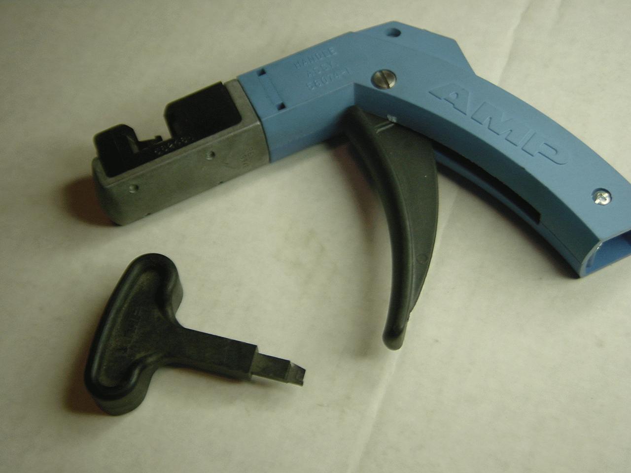

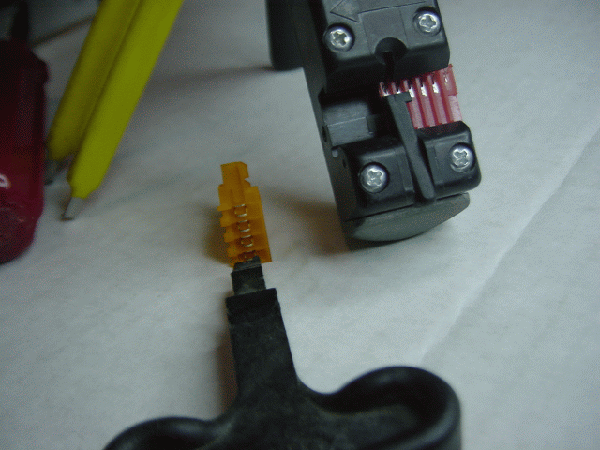

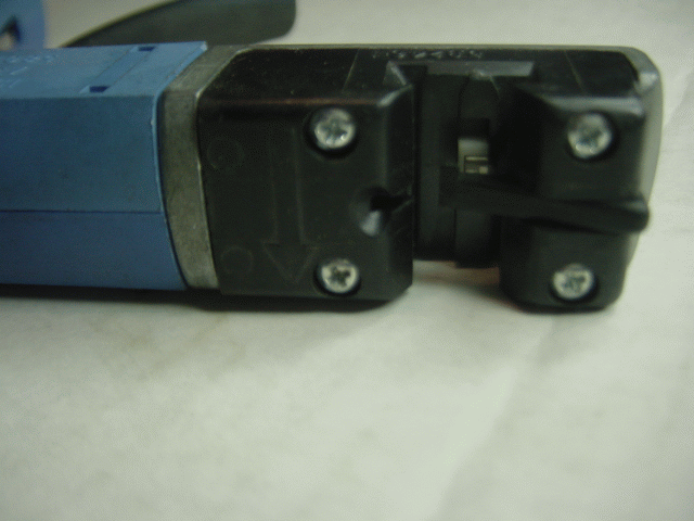

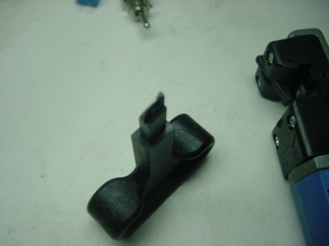

loss1234 wrote:
anybody have a link for a tutorial on putting the MTA connectors together without the special tool??? (the kind used with the MANKATO FILTER) i have heard that a jewelers screwdriver can work but i cant figure out how to do this..... thanks'
Hi Loss,
The screwdriver method can work, but I had a high rate of failure doing it that way so I purchased the tools. Others have said that soldering these was the key to their success in using them without the special tools.
Perhaps it will help to see the special tools in relation to the problem?
Here are pics of both the cheapie AMP "screwdriver" replacement, and the expensive (and very much worth it!) pistol grip AMP MTA connector tools.
Pic 001-The cheapie T-Handle is .156 size and the pistol has the .100 size head installed.
Pic 002- A closeup of the Cheaper T-handle tool. The focus is not great and the need to shrink the photo size for publication makes it hard to see that the end shape is like the capital letter "I". There is a thin spring steel middle, with plastic top and bottom molded around it.
This tool of mine was the first I purchased and I thought it was going to work with .100 connectors but it is the .156 size. So I turned the "I" into a "T" by milling away the plastic on the "bottom" so I could use it on the smaller MTA.100's. The thin steel blade of this tool is what you're trying to replicate with a jewelers screwdriver. The top and bottom however, will not be replicated and this is the first part of what makes the use of a screwdriver for the task difficult and fraught with poor results. The top and bottom wider parts serve to guide the thin steel middle blade. More on that in an upcoming pic.
Pic 003- A closeup of the empty pistol head. The molded arrow shows the direction the connector will move as you insert wires into the notch at the left middle of the head, and then when you squeeze the "trigger", a plunger goes from left to right (in this pic) and presses the wire into the connector metal piece.
Pic 004- A loaded pistol, ready for the first wire. And the t-handle in position to press a wire in place. here you can see the T shape mentioned earlier. A new, non-modified tool is an I-shape. You can also see how the connector housing has a space where the top and bottom wider parts will go to guide the tool as it is pressed "away" from us (in this pic)
Pic 005- Using my fingernail, I pushed a couple wires into the connector hard enough to get them to stay in place long enough to use the T-tool. Again you can see that the wire extends past the middle METAL IDC (Insulation Displacement Connector) portion of the connector. The wider parts of the T-tool are blunt and will guide the insulation down in these areas as the middle portion is "stripped" by being pushed into the narrow slot of the metal part of the connector. The danger with a screwdriver is that it will not only strip the wire in other places due to the pressure required, but also that the wedge shaped blade can easily distort the narrow notch of the IDC connector metal, making for a poor connection.
it's also easy to slip and plunge the screwdriver into your fingers holding the connector body upright. Uh, not that I'd know from personal experience mind you! Very Happy Embarassed Wink OUCH!
That metal slot is another key to success with these connectors. These are NOT a one-size-fits-all type. Each one is made for a specific range of wire gauges. Often this is color coded. Be sure you have the right MTA connectors for your wire size(s)! Since the connector works by slicing the insulation away to make contact between the wire and metal part, if the wrong size is used you can have either no conection, or worse! (because you don't notice it at the time) a non- gas-tight connection which is loose and will fail over time. Or just be a source of frustration with intermittent problems which are hard to find.
Two more pics coming up, the e-m post size is limited.
Kind regards, Randal
