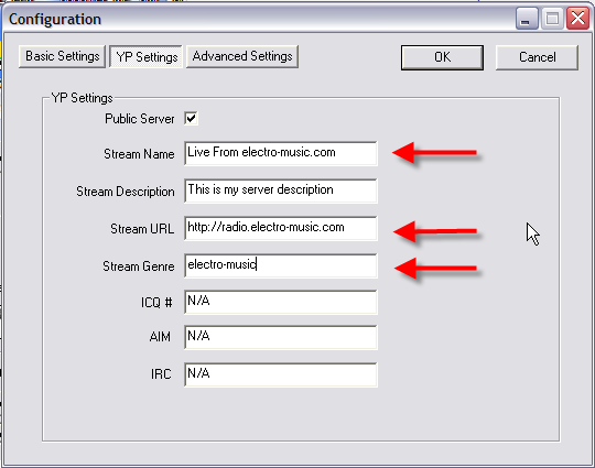

Now click on the YP Settings Tab at the top of the configuration window. You'll see this:
You can use a different stream name if you wish, to describe your event.

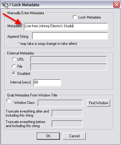

Finally, Click on the Edit button next to the word Metadata near the top of the window. This is where you put in the title of your performance. Put that in the Metadata field - leave the rest of the stuff alone.
You can edit the metadata anytime you want while you are streaming. If you are streaming a concert you may want to make the metadata identify who is performing.

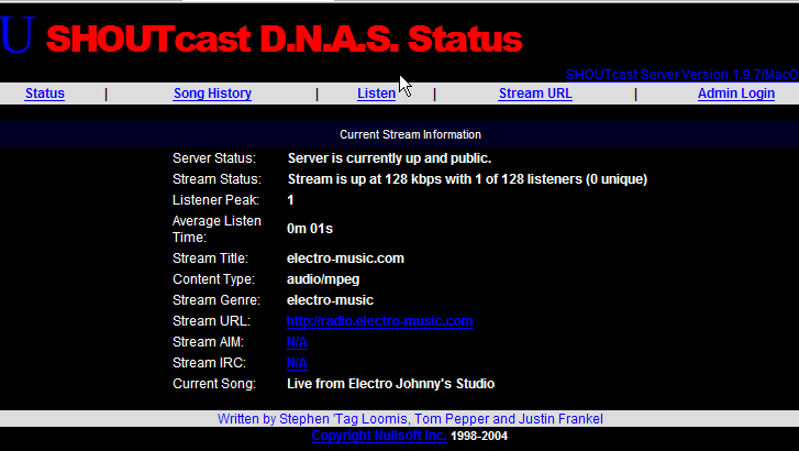

When you check out your server page http://radio.electro-music.com:8070 (use your port instead of 8070) you should see something like this:
