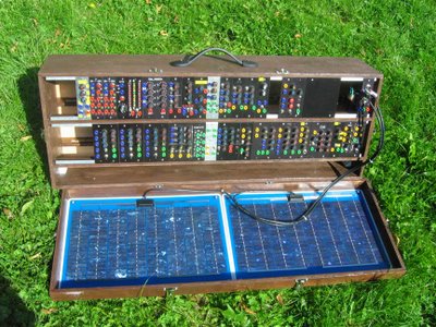

i remember bugbrand building a solar powered synth.i think this is a good idea for a future project

bugbrands solar modular vary nice!
http://bugbrand.blogspot.com/2007/07/solar-power-modular.html

Offlist reply from Bugs himself:
I'll try to collect my thoughts a bit and post something to the em forum --- I shamefully don't get in there much these days it seems...
Stupidly I never actually drove my modular DIRECT off the solar panels --- really ought to try that out though as I've still got those big panels.
Interesting things to bring up would be:
- good idea on the dynamo torches - you can get SHAKE ones too.
--- many simple electronic sound makers require really low power -- its the output amp that requires the most power!
- super caps (caps of 1farad or so - generally low voltage though) and memory protection batteries (that's what I used for the last solar-weevils (though these actually weren't so good 'cos I stupidly used SMD stuff and the 386 pwr amps turned out to have a lower output than the standard through hole ones I'd used before --- still I got to climb trees in Lisbon with them))
Oh yes and:::: http://www.flickr.com/photos/bugbrand/2655674860/
very, very simple...
Best!
D.
