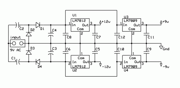

hi all,
i designed a PCB layout of a small PSU for my soundlab.
it converts 9V AC to +12/-12V DC and +9/-9V DC (approx. 100mA). actually its a counterfeit of the doepfer a100 miniNT.
using a wallwart transformer (9V AC, 500mA) you don't have to care about high voltages!
http://modular.fonik.de/soundlab/sl_psu.pdf
the layout is a positive for press'n'peel blue...

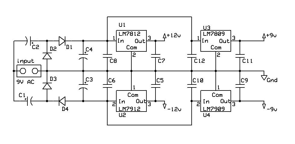

That looks nice! Do you have a schem you can post of that?
C
PostPosted: Mon Aug 21, 2006 4:48 am    Post subject: Reply with quote  Mark this post and the followings unread
here we go:
C1-C4 electrolytics 2200uF, C5-C12 ceramics 100n, D1-D4 1N4001
