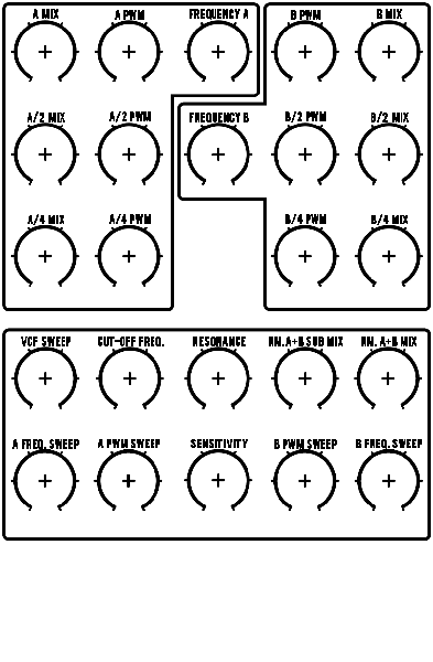

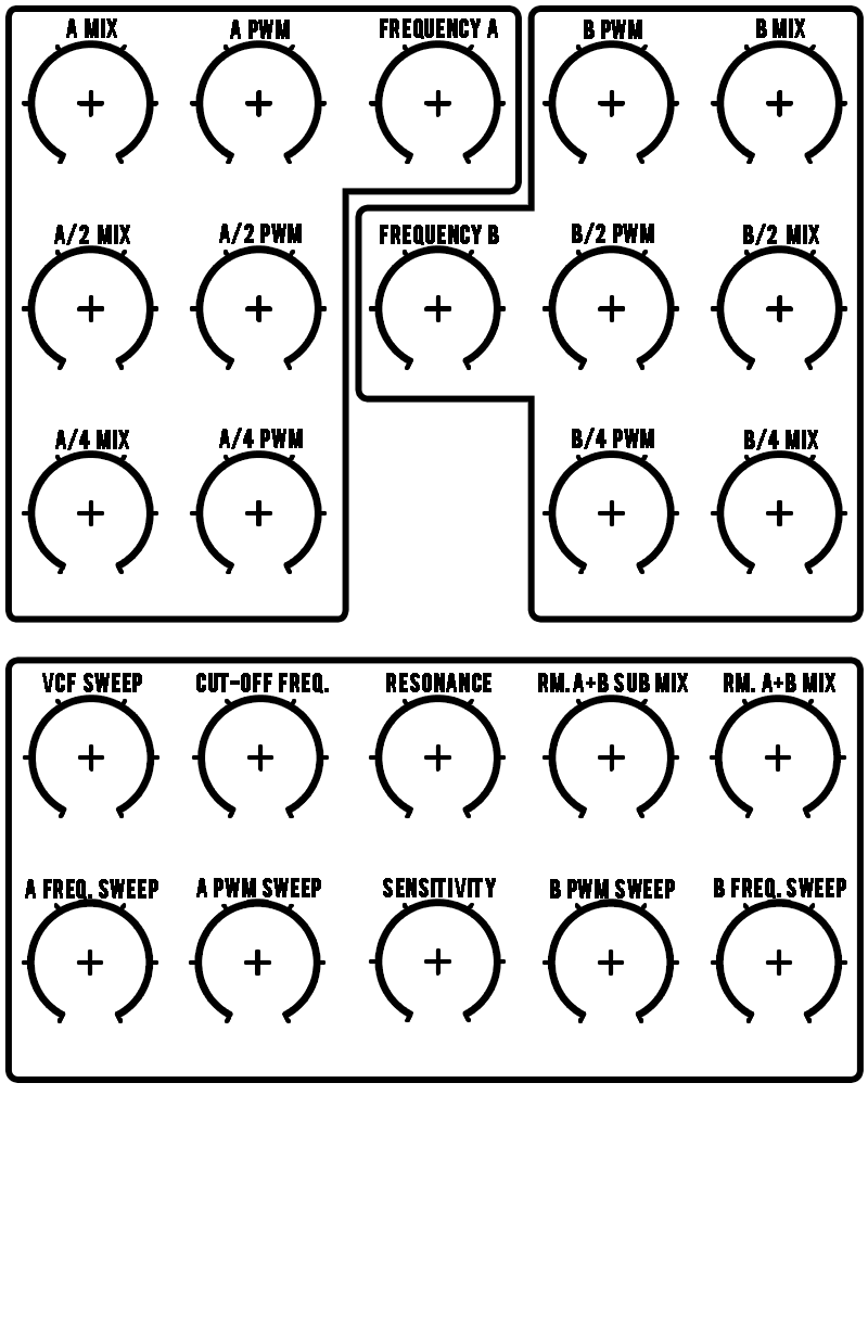

I've been working on a guitar synth the past few days. I'm building a mini and mega version. Basically the mega version has more sub-octaves, pwm, and a vca for A/D controls.
I'm stuck on the layout. I just can't decide how I want things laid out. Ideally, I want each section (mixer/pwm/EF, etc) together but trying to lay them out symmetrically has been difficult for me. The posistion of the knobs must follow to the layout in order to fit in the case properly. Any suggestions would be greatly appreciated!
Just to let you know I'm not using 1v/oct frequency converter to control the vco's and it tracks pretty darn well. I'm sync'ing 40106 vco's that are based around my design. It's a fairly simple circuit that is a helluva lot of fun to play with!
The layout doesn't have the stompswitch or led indicator on there yet, but it'll go in the middle towards the bottom. The back will have vc inputs for each pwm, vco freq, and vcf.

I nixed the layout and have decided to build two different boxes. One for voice another for control. The voice will have the fundamental, sub-octave, and 2nd sub-octave, with ring modulation, vcf, vca and possibly an aliaser. The control box will have a couple EF's, LFO's, S&H, 2-4 photocells and maybe dual joysticks.
I will also be building one giant box that includes everything.

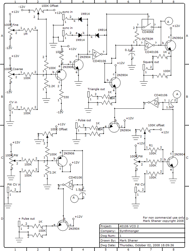

Well actually I'm syncing the 'vcos' with an amp tied to a diode facing the input of one 40106 oscillator. I'm using another gate of the 40106 as a high frequency exponentially controlled VCO that is driving a 4066 switch. The input to the switch is connected to the input of the sync'd 40106 oscillator and the output of the switch is connected to the output of the 40106 oscillator. The switch is basically an easy peasy VCO/resistor. I'm getting -.06 to 500k resistance on +9v power. I haven't tested the resistance with different power supplies yet.
I tested the same VCO/resistor method with a number of things with 100% success (toy voice changer, BPF, LPF, aliaser, to name a few). One super-awesome-cool-fun thing to do, is controlling 4 40106 gates with one vco/resistor that each have optional manual frequency control. The best thing about the VC resistor is the sync/linear/expo control via the vco driving the switch.
You can use 1 of 2 switches (4053) to act as a vco/resistor too (i.e. voltage divider). I haven't tested out the 1 of 4 (4052) or any other electronic switches yet.
Now all I need to figure out is voltage controlled capacitance!
I'll post schematics of my guitar synth after I get everything finished. For now, here's a tri/square vco with a few different control options. Also, you'll need to add some extra circuitry to get a symmetrical triangle wave. If you leave it as is in my schematic it's a lil floppy.
EDIT: The VC resistor is in the VCO schematic. just leave off everything after the switch. Use the input and output pins on the switch as a floating vco resistor.

what program is that .sch file from ????
synthmonger
Joined: Nov 16, 2006
Posts: 578
Location: flada
PostPosted: Mon Oct 13, 2008 7:28 am    Post subject: Reply with quote  Mark this post and the followings unread
Ray Wilson schematic builder. I accidently upped that while I was uploading the .png
I know you were looking for an easy VC resistor a while back and I think you could get a ton of use out of mine. Give it a shot! Very Happy
