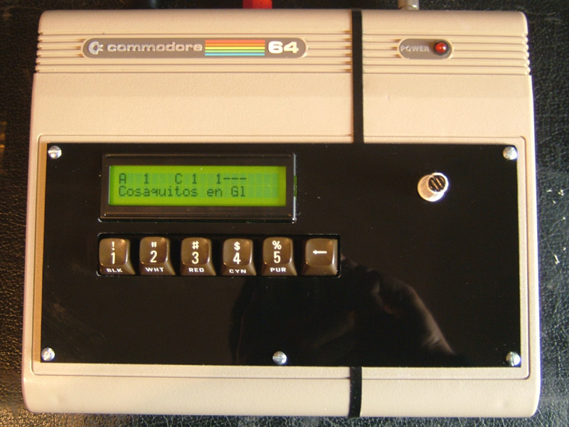

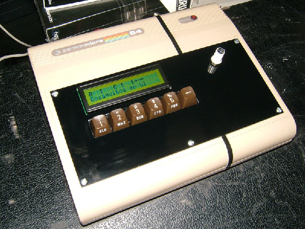

Here is a picture of my Mini64, a MIDIbox SID V1.
(from http://www.ucapps.de/ of course).

That's exactly what my Mini64 is: a DIY synth with a single SID chip.
In the MIDIbox SID V1 you can choose to build the synth with 1 to 4 SID
chips.
In version 2 you can choose between 1 to 8 chips.
Also you can choose how simple/complicated the user interface will be,
from nothing (you can control everything by MIDI) to a full UI with an
encoder for every parameter.
Mine is a intermediate UI.
Go to http://www.ucapps.de/ you can see all the details there.
