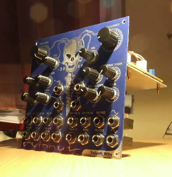

Dual YuSynth VCOs.

Very nice work vinnui. How tall is the module and how did you do the artwork?

The module dimensions are 168 x 168 mm (nonstandard).
The graphics was drawn on paper first, and then scanned to a bitmap image file. After some postprocessing, this image was fed into Inkscape's bitmap vectorizer plugin, and finally i've corrected the errors. After that i was able to insert the graphics into the panel design (which was made also with Inkscape).
The faceplace was made with acid etching, and spray painting.
