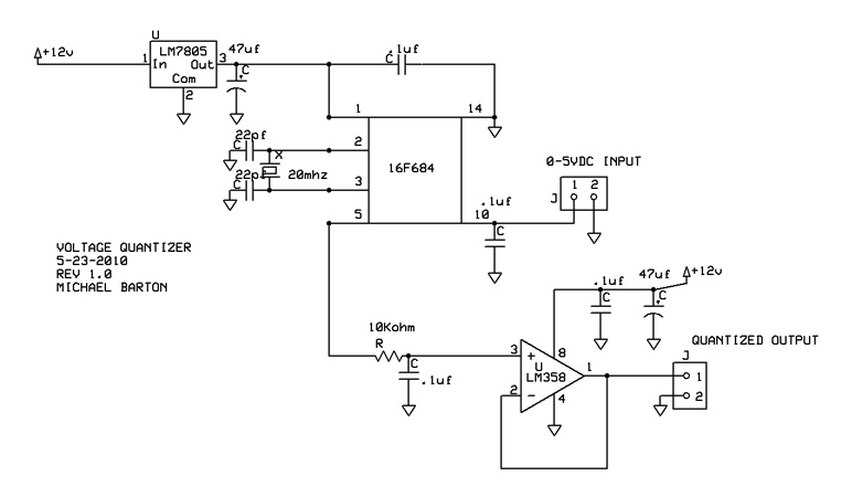

Ok, everybody, this is my first synth design and also my first time programming anything, so I'm a little bit nervous about putting this out there.
This is a really simple quantizer circuit, the idea was to have somthing small and simple that could be tacked onto the end of a sequencer design or something. A voltage between 0-5VDC is inputted to an ADC on the PIC. The PIC then outputs a PWM of the nearest 1/12th of a volt. The PWM is filtered and buffered and sent on it's merry way out.
Right now I've only breadboarded the circuit, I need to put a cabinet together before I can start building any more modules. I got a bit of noise on the output which I think is from using a common ground rail for the PIC and the buffer, hopefully this will go away when the circuit is built on a proper board.
I've attached my assembly code as a txt file (couldn't get the .hex or .asm to upload). This is the first thing I've ever programmed, so it's probably going to seem very inelegant.
I'd love any feedback on this.
EDIT: I'm adding a txt file with the assembler code for a version of this that has variable modes (I mean modes in the musical sense). The only thing you'd need to change hardware wise is adding a pot with it's outside lugs going to +5VDC and ground and it's wiper going to pin 9. This pot will select what mode you're quantizing to. From least voltage on pin 9 to most the sequence is Major, Major Pentatonic, Minor, Minor Pentatonic and Chromatic.

nice design!
looks like a very nice project, simple diy quantizers are still kind of rare.
The approach with PWM is also nice because of not needing DAC´s.
I have still some PIC ´s here i will defenately build one.

I think you want an ICSP programming header. It is six pins on .100" spacing, there are lots of examples out there for Google to find. Works great with PICKit 3.
When I looked at the assembly code, I did not know that instructions such as SUBLW .32 were allowed. I'm not sure what the assembler does with the decimal point.
Anyway, good luck, it looks like a real nice project!

Hello
Well done
This is a neat idea !
I had a look at the code.
You could make a compact code version if you divide
the VOLTHI value by 4.25 [60 steps for an 8bit ADC value]
Make the result Integer [no remainder] then multiply back
up by 4.25 to give a quantised result for the PWM [so long as the PWM gives a 0-5v range]
Would this work ?
If you have enough output pins you could try a "hand rolled"
DAC with 1% resistors [like in the Roland TB303] which
does work pretty well.
Keep us posted
-ryk

Yerpa, .32 means 32. The decimal just tells the compiler that the value is entered in decimal form. It's like putting the b and apostrophes to indicate the number is entered in decimal form. So .32 = b'00100000'
Ryk, I think I understand your concept, but I would think that dividing by 4.25 would take some very tricky math when working with 8 bit numbers in assembly code. Right now doing something like that is definitely over my head.
Also, I would like to experiment with using r2r ladders as a DAC in the future. I like the idea of not having any aliasing from the PWM, and making your uC's clock less critical. But for this project I wanted it to be compact and cheap and an op amp, 1 resistor and 1 cap on the output is a lot smaller and cheaper than 20 precision resistors.

To be able to make various mods without major board modification is excellent. I'm sold and off to buy a pic kit. Very Happy Very Happy
iopop3
Joined: May 28, 2010
Posts: 94
Location: Malmö, Sweden
PostPosted: Sun May 30, 2010 3:05 am    Post subject: Reply with quote  Mark this post and the followings unread
This looks interesting.
You might want to move the pwm store code into its own subroutine to save some bytes,
Code:
SETDb1 MOVLW.4
       GOTO SETPWM
SETD1  MOVLW.9
       GOTO SETPWM
 etc etc
SETPWM
       MOVWF CCPR1L
       BCF   CCP1CON,5
       BSF   CCP1CON,4
       GOTO  BEGIN
For making lots of different scales, how about table lookup? One 256 byte table per scale, use input value from adc as index in table, store value to pwm. This assumes adc is 8bit.
Generate the tables by highlevel language of choice, php/java/c++/perl/javascript etc..

I implemented some table lookups to the code and was able to shave about 1000 lines of code off! I've also got it automating the threshold's between notes, which will make future implementation of switches and user defined patterns even easier.
I also added two more modes, blues scale and whole tone scale. I also wrote some better notes in the code for this one to make it easier to follow for anyone checking the code.
Blues scale is really fun, you can get an authentic cheesy guitar solo from just going up and down on the input voltage.
Thanks to everyone who has posted in this thread. I'm a beginner at this stuff and your suggestions are leading me to a lot of learning and improving my coding skill. I'm starting to really enjoy this programming business.

I got the quantizer working. Lot's of fun so far. I noticed that I'm getting a pop in the output from the quantizer. The pop is cyclic and repeats every few seconds. Anyone else getting this issue?
Oooo! I'm looking forward to this! (Now also, thanks to your suggestion that helped get my PICkit 3 up and running. Currently going through lessons with it.)
Once I learn a few more things, I'd like to try a whack at this as well.
As to the pop - what about applying the formula for the output cap. from the Tips and Tricks.pdf that's listed in the PWM section. Maybe that could help?
Thanks for the tip. I'll take a look at that document.
