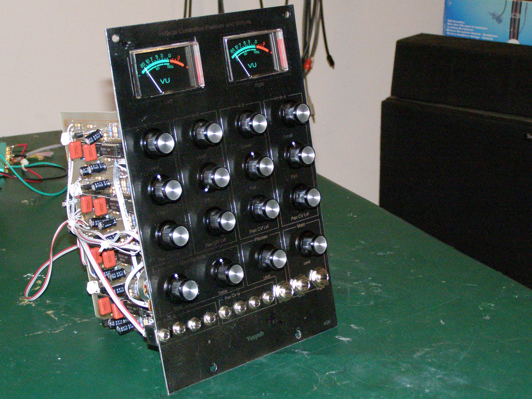

PostPosted: Sat Sep 18, 2010 11:53 am    Post subject: Reply with quote  Mark this post and the followings unread
Just finished this -
Yusynth vc panner front
Yusynth vc panner profile
Yusynth vc mixer/panner back 1
and the low budget bracket I used for this - I am waiting on an order of brackets from the bridechamber, but wanted to get this done, so made a bracket out of 2 pieces of stair flashing from Home Depot - 44 cents each(!). It's not the sturdiest thing in the world, but it'll work for this.
Yusynth vc mixer/panner back 2
It all seems to work fine! I still haven't calibrated it - what do the trimmers do anyway? I suppose I could just mess with them and find out. I do notice that in the default way it's set up with the trimmers in the middle, that I'm not getting a complete pan - I'm still getting a pretty big signal in the left channel if I pan it all the way to the right (and vice versa).

PostPosted: Sat Sep 18, 2010 12:21 pm    Post subject: Reply with quote  Mark this post and the followings unread
Beautiful panels indeed !
Yes I realize that I forgot to put the trimming instructions on my site. I will fix that ASAP, until then...
Concerning the trimmers : these are used to adjust the midrange for the paning.
Basically you can simply use a voltmeter and adjust the trimmer in order to measure -4V on the wiper pad.
Then send a triangle wave (1kHz) with an amplitude of 10Vpp (-5V/+5V) on the input of the channel you wish to trim.
Set the PAN LEVEL pot to 0, and the PAN pot to 12 o'clock.
Connect a dual channel oscilloscope at the outputs. You should obtain the triangle with equal amplitude on both channels, then turn the PAN pot from Clockwise to Counter-clockwise position : you should observe the disappearing of the triangle on one side and the increase in amplitude on the other side.
Now, adjust the trimmers such that when the PAN pot is at 12 o'clock, the amplitude of the two triangle waves is roughly half of that can be measured for one wave when the PAN pot is set to clock-wise or anti-clockwise positions.
But if you have set the trimmer to -4V before you should be very close to the right setting.
