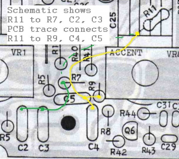

Hey, again! So I've decided for my next project, I'm going to convert my drum machine into something I can use with my modular. I have a boss dr-55 that i got off of ebay a while back.
So far I've got trigger inputs to trigger The snare and rimshot, I plan to add triggers for the rest of the drums of course.
I also have the bass drum mod added on.
Now I want to get as much as I can out of this little drum machine, but I don't want to go through it looking for nodes to attach as I'm afraid I might fry something. So I thought I would as the lovely electro-music.community.
Have any of you modded this instrument? I found a rimshot clone on here that had a "tone" feature that I would be able to add to my dr-55. Other than that though, I'm really not sure what approach to take. If you guys could help that would be wonderful!
I'm going to supply a schematic and all for you to take a look at.
Thanks guys! I'm excited for the possibilities with this! I hope to get some sort of mod list going for other Dr-55 modders, because I know they're out there.

Found an interesting error or mod with the BD
The input resistor, R11, goes to a different node on the PCB than it does on the schematic.
When compared to the BD on the DR110, the DR-55 schematic is correct but the PCB diagram as given in the 1st post (from the service manual) is wrong.
Could someone check if this was fixed on a real PCB or did the error remain as shown. If it is the same on the PCB as shown in the service manual, perhaps a switch to re-route the trigger signal to the 'correct' node might be worth trying.
edit - schematic is correct, sounds much better. The PCB image in the service manual is wrong.....so what about the real pcbs??
As for the RS, replace R44 with a 4k7 resistor in series with a 50k to 100k pot wired as a rheostat allows you to tune it, also changing R40 to a 10k pot in series with 4k7 lets you set the 'ring' of the sound, either extreme gets it to oscillate at an annoying frquency or reduces the sound to a click. Personally not worth modding for me, but the Tune mod is ok.
