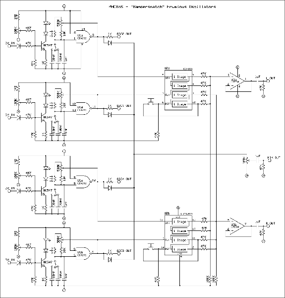

first, the part that started it all, which I named the frumious oscillators. I began with just 4 NAND oscillators attached
to the CLK and Data inputs of the 2 shiftregisters (CD4015). I also added some resistors to the outputs that were unused in
the jabberwock (12, 3) but connected them to the opposite channels (L/R) for some extra stereo effect. There's also a switch
connected to the RST input which, when closed, cuts out 1 (U2a) or 2 (U2b) stages of the shiftregister and changes the
waveform. creating a sharper higher pitched sound. I should record a small demo,. or test it yourself Wink
(for more info I suggest reading the CMOS Waveshaper thread)
As I mentioned the next thing I added were the LDR's, for this I used a configuration that I had used before in circuit bend
devices, namely putting the LDR parallel with the pot. This makes it possible to have manual speed control, but at a
certain point the oscillator won't just go slower, instead the LDR starts taking over. (no effect when it's in darkness).
you could put a switch in series with the LDR, so that you can turn it off completely.
note: I put the LDR parallel to the pot + series resistor, because even in full light the resistance is high enough not to stall
the oscillator.
For a wider range I added a switch with 2 extra caps. The switch has a center position which provides 3 different
ranges. (1nf, 1nf + 10nf, 1nf + 100nF)
of course I didn't just use LDR's but turned them into vactrols. I used a simple transistor driver similar to what's used in
the wogglebug. I didn't put the extra control pots in initially which is why there are only 4 pots on the panel (the sloped
one on the right side) instead of 8. But after having build some more circuits for it, I decided that it would be very usefull
so I made an extra panel. (the horizontal panel in front of it)
I also swapped the pots, so I now have the CV control pots on the sloped panel and the speed pots on the other one
(made more sense to me that way). because I had some extra room on this panel I also added output jacks for each
oscillator and an attenuated diode mixed output.

ok, one more thing: The LED light. This was a USB light but I cut of the plug, replaced the LED with a bright pink one and
painted it in the same colors as the panels. It also has a transistor driver and is attached to the D output of the multiples.
This way I can let the Bandersnatch interact with other devices that have a build in lightsensor.
edit: added a transistor inverter to the CLK input, swapped STR and INI pins, and added a transistor inverter
to this aswell. updated schematic.

PostPosted: Sun Feb 08, 2015 9:41 am    Post subject: Bnadersnatch Multiples update
Subject description: buffered input
I made a change to the multiples. Yesterday I tried to use it to distribute a CLK signal to several synths but since
the source signal only had a 5V amplitude this didn't work. To solve this I used the transistor from the LED driver
as an input buffer and used the XORs as inverters. Cool
PHOBoS - Bandersnatch - Multiples V2
 Filesize:  44.7 KB
 Viewed:  308 Time(s)
