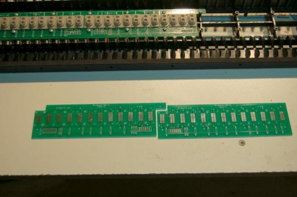

I started off to build a simple cv keyboard, but "feature creep" crept in (pun intended) and it turned into this.
I made up some pcb's to retrofit the Fatar keybed to be a resistor network.
The keyboard has 4 buffered outputs each for CV, Gate, Trigger, Bender and Modulation (sine and square outputs),
it will also have a ribbon controller built in, but the ribbon will be on a separate pcb (for now anyway)
For controls it has an Octave switch, fine tune, portamento, LFO rate and amplitude, a scale control for the ribbon
and pitch and mod wheels with a switch to route the lfo sine to the keyboard cv
The keyboard can be scaled for any size keybed, I designed the keybed pcb's to be "modular" there is one pcb
for the left side and one for the right side, the pcb's in between are all the same (1 octave each)
So far everything is working as it should, I missed a couple of holes on the right keyboard pcb, and integrated the
octave switch and output board on to the keyboard pcb, so right now I am waiting for them to be made.
The biggest problem is trying to find keybeds and pitch/mod wheel assemblies, I have emailed Fatar numerous times,
but have never heard back from them, so for now the only option is to use salvaged keybeds, so if anyone has any
non functional gear with the fatar keybeds in them, let me know.

...and here is a pic of the retrofit boards, two are installed, the resitors are mounted on the bottom but
they could also be on the top if you want
 Filesize:  33.68 KB
 Viewed:  179 Time(s)

Can you post some details on the pcbs (schematic, parts list, etc.)? Does it use a constant current source and resistor ladder type approach? Are you planning to sell these?

I thought about using a similar solution, but I was always concerned if the rubber contacts introduced any resistance - Can I presume that the contacts act as a clean switch and pass through the CV voltage cleanly?

Bill's pcb still scans a diode matrix keyboard, which is the best way if you want CV and Midi.
My keyboard is strictly CV, the main circuit is based on the Roland M181 keyboard, with a few tweaks, additions and modifications.
