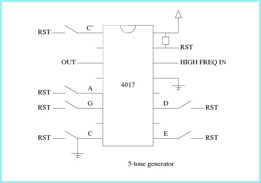

trav
Joined: Sep 11, 2012
Posts: 108
Location: Auckland
PostPosted: Sat Apr 06, 2013 6:20 am    Post subject: Reply with quote  Mark this post and the followings unread
The pentatonic circuit is really simple. Send a fairly high frequency into a 4017. RST is tied high by a pull-up resistor, so OUT is usually low, but closing one of the switches connects reset to one of the output pins, dividing the original frequency and putting it on OUT. I fed this into a ripple counter to square up the signal and get a few more octaves.
The diatonic circuit was a bit more complicated, but basically the diagram above plus a few more dividers to get a three-octave keyboard plus 4 octave/sub-octave switches to get a range of 6 octaves altogether. Polyphony sounds alright when only the top octave is activated, after that it gets all diode-crunchy. As for the build, I'm not much of a pianist; what I really am looking forward to is seeing what kind of melodies the lunetta can make on its own, hence the use of crappy switches for "keys" while the jacks are for patching the notes elsewhere.
have a listen, tell me what you think
 Filesize:  8.02 KB
 Viewed:  15966 Time(s)
5-tone.mp3
Download
 Filename:  5-tone.mp3
 Filesize:  513.75 KB
 Downloaded:  351 Time(s)
7-tone.mp3
Download
 Filename:  7-tone.mp3
 Filesize:  1.04 MB
 Downloaded:  327 Time(s)
Posts: 3807
Audio files: 562
PostPosted: Sun Nov 10, 2013 4:44 am    Post subject: Reply with quote  Mark this post and the followings unread
hmm. I think I somehow missed your last post Embarassed
I like the simplicity of the 5-tone generator Very Happy and it does sound like the melody generator. 7-tone seems to be a bit of but it's not bad. I actually
found a circuit in an old elektor which is similar in concept to the one richardc64 posted. It's designed to play a fixed melody (Big Ben) but I think
it would be possible to use it in a similar way you made the 5-tone generator. I probably won't be trying that anytime soon though, and I allready
have a lunetta keyboard anyway Wink
I just had a listen back to what was admittedly not a great demonstration. When you say it sounds a bit off, I think in the beginning I played a minor scale: is this the offness you mean? (You get some major arpeggios later) I think I wanted to demonstrate the full range, and you can see from the keyboard layout I begin and end on A (Cs are the red switches).
Of course, the whole thing is a bit ramshackle, so it may just be that. But it is fun to play with. I like to patch the tones into a multiplexor clocked by random bits: you can hear this on the attached patch.
