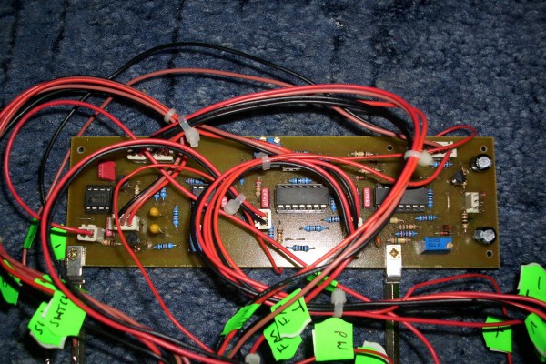

Hello everyone!
I've been watching this forum for a few months but now I decide to don't bother Yves by private mails Wink and join the group.

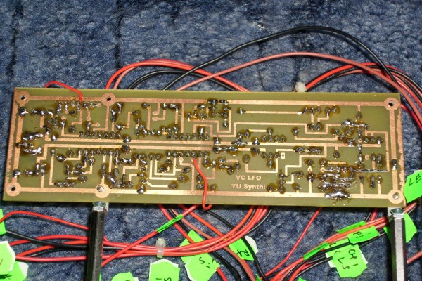

Some years ago I bought on ebay a LFO's pcb as a project. This year finally I've started to make a 3VCO yusynth system and I wanted to put the old LFO in. When I finished, wired and trimmed the LFO module I realize unfortunately that it doesn't sound like an LFO. The sound is drifting down. I mean - the pitch of rate is slowing down constantly (no cycles at all). The waveforms on scope are not ideal but looks quite good.
As I have the basic electronic skills I don't know how to fix it. I've read all topics about LFO's issues but find no solution.
Anyone of you have similiar problem? Any advice?
Thanks for answer.
Greg
I've attached photos of pcb (as you can see it's in poor state in some areas)
 Filesize:  1.18 MB
 Viewed:  160 Time(s)
 Filesize:  1.26 MB
 Viewed:  160 Time(s)

I replace BC557B, LM741 & TLC555. No results.
That's all I can do Crying or Very sad

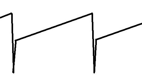

Obviously my issue is connected with too much high frequency. For some reason I couldn't dive too low by the rate pot and T1 trimmer.
In the meantime, I resoldered all solder points and replace c10uF 25V for 35V (I don't know is it relevant?). Then I decide to make a test, the same as Sebo made for Yves:
OK check the voltages at the output of the 741 (pin 6). First adjust T1 to have 0V at its wiper pin. Then when cranking the frequency pot from min to max you should measure a voltage varying from 0V to -7V. Next measure the voltage at the base o Q1, there you should get something a voltage from 14,55V to 14,35V, that is a variation of 0,2V. If you have values significantly diffrent from these then the problem comes either from R1,R3,R5,R6,R7 or U4.
So I removed BS170 and measured 0V to -10.80V at pin 6 of the LM741 and 13,80V at base of Q1.
I replace R1,R3,R5,R6,R7 (by 1% in place of 5%).
That's all I did.
Now... Core signal is still unstable. When switch is on 1.0 position I have a frequency from 1000 to 8000 Hz and close to 8000Hz the signal is falling down about (50Hz/s), then about the middle scale of rate close to 3000Hz it is rising (10Hz/s)and when rate pot is close to minimum the signal is falling again.
In 0.1 switch position the frequency has the range from 20 do 1000 Hz - in the maximum the signal is rising up (10Hz/s), then close to 400Hz is drifting up and down and close to minimum - falling down again (5Hz/s).
So - the low frequency is appeared (that is a little progress) but when signal is starting to make a cycles (finally!) on a slow rate - it has maximum 1s long and soon it's falling down and became constant low (no cycles).
I tried to take a photos of the waves on my analog scope but with this unstable signal it is impossible - all photos are blurred.
Apropos: what about the waves? Now the waves are not good as before. 10V sawtooth looks like at added .jpg file.
The sine and triangle waves are far from their ideal, only the square/pulse looks good.
I hope this time I explain my issue better.
Thanks in advance for any help!
Greg

PostPosted: Sun Dec 22, 2013 10:32 am    Post subject:  SOLVED! Reply with quote  Mark this post and the followings unread
Problem solved!
You never guess what was the reason of issue: partially-damaged wires.
I couldn't find the fault too long and I gave up - I made the new PCB, I bought new parts, I used the wires from the old PCB and... it wasn't working Mad .
I checked several times all connections, solder points, wires and all seemed to be ok. Then I accidentally bent the wires and the unit back to life for a one second Very Happy
So after replacing the wires, the LFO is in perfect working order.
I have to keep in memory Idea : always change old wires to new one.
Best regards,
Greg
