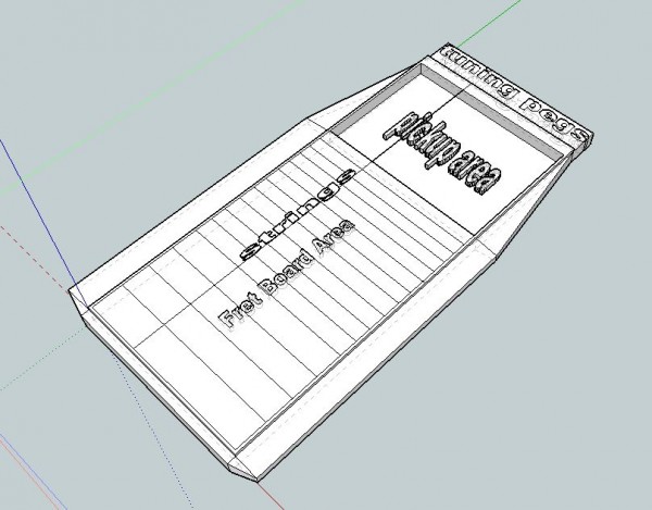

By combining different design elements from the different instruments, I came up with a concept that I would like to build.
A 24 string tapping instrument using the strings from a harpejji, the frame idea from the tapladder, the fretboard idea from the kelstone, all wired up like the harpejji.
what I have so far is.
the sting list from Marcodi. I used that to determine that the scale length should be 31 inches.
the frame concept from the tapladder could be adapted by using bedrail angle iron and a welder.
I would build a wooden fretboard, and use guitar electronics.
My first problem is that the string spacing is 9/16in or 14.29mm.
the harpejji uses saddlemount pickups but those things are $200 for 6. not an option. I need cheap parts. EBAY FROM CHINA cheap.
What would be the best way to adapt regular pickups to this string spacing.
how do I tell the difference between pickups with pole magnets and bar magnets. Can they be placed at an angle so the pole magnets read the strings better. should I just build pickups with the right spacing.

Hi RevJack and welcome to the forum! Very Happy
I love the sound of tapped instruments as well. I made a quick prototype to see how hard it was and found it not too difficult. Being precise is obviously paramount, esp when it comes to fret placements. I'd suggest you may have to build one or two instruments first before you get it completely right, but you can reuse the parts from old designs. When it comes to pickup placements, as a very general idea, the closer you place them to the end of the string, or bridge, the thinner the strings will sound. Messing about with different placements before committing is the best solution.
Pickup type... for tapped istruments, it is possible to place the pickups closer to the strings since they move a lot less than when you pluck them. The obvious choice for me is to use active pickups, since they have weaker magnets and therefore won't pull on the strings so much. You therefore find that you get a much longer sustain from less dampened strings. Pickups all sound very different and is a personal choice though.
For me, making the frets is the most difficult part - you may want to buy fret wire, apart from the machine heads and pickups. You can roll your own on these too but it will make things much more involved.
For the easy maths involved in fret placement and much else you'll find a lot of info on this site: http://www.liutaiomottola.com/

Being a Stick player I'm always interested in new tapping instrument endeavors! WRT pickups, do you have to have saddle pickups or can regular guitar style pickups work? Saddle pickups can give you separation between strings which is good if you want to drive a Midi convertor or process the strings individually. But as you've seen they can be pricey. The Roland GK pickups are 6 individual magnetic pickups that can be removed from the housing and spaced as needed though you will not be able to get closer then ~.3" center to center. The pickups can be had relatively inexpensively on the used market, though it still will be more then regular guitar pickups.
You could try to roll your own...either magnetic or piezo/contact style. Years ago I wanted to mic the flute and process it thru delays and such but wasn't happy using a mic and flute pickups were expensive. I ended up taking an old transistor radio earphone and threading it onto the flute head stop to the point where it just made contact with the earphone diaphragm....worked great! Now with todays technology reducing the size of things, you might be able to get ear-buds to work. Either as a contact pickup or maybe as a magnetic device though it probably won't be strong enough...

Muied Lumens ,I really like that adjustable bridge. I'm actually thinking of going this route with adjustable pieces made from brass L brackets.
https://www.youtube.com/watch?v=OXRJCtkJskQ
https://www.youtube.com/watch?v=LzEeEMyzkjo
As for the pickups. I'm actually trying to avoid saddle pickups due to the cost.
I'm building this thing so that it is actually pretty modular. For eample, the fret board is a 14 x 21 piece of wood with the frets that just drops into the metal frame. That way, If I mess up, I just redo THAT piece. The same goes for the pickup area. I NEED to go as cheap as possible now, but I can easily upgrade later. I just wanna know if I can make it play right.
I'm guessing I will have to go with 4 or 6 BLADE pickups if I can find them cheap enough. I am even considering making my own, but I need to see which is more cost effective.
If I do make them, I might experiment with making a Gittler style tube pickup. Making one for each string.
making them might be better anyway, cause I might also have to custom build sustain drivers at the same time.
