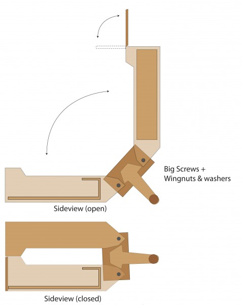

Update:
After some checking i am convinced that the cheapest solution is to use gravity and wingnuts (for the beginning)
as long i dont us super cheap and thin wood it will do.
Here is a picture of the forces at work. i think a few degrees of the top part tiping to the back will stabilize it even more.
also i thougth about adding a ligth to the otherwise useless top lid... and some cable holders to the upper sidepieces Smile every inch must have a purpous!
also i had another look at my older cheap 19" rack i had build for my vermona drm1, the current modular setup and my mb33. i had no rails or anything to hold my gear in place. just screws washers and wood. so i just pre drilled smaller holes and entered a screw one number bigger.
i still carry it around for live and it holds like a tank. only thing is... i cant replace stuff :/ which is pretty bad for modular but i wound come to the point off replacing until next year june sooo... i just skip the rails and rack ears (my modules are mostly secondhand and all have rackrash... cause people sell modules cheaper when they have rackrash. so i just dont need to bother about that...) thus saving money... 100 euros Smile yes!!!
So it will be just the wood i need to buy... ofcourse i will construct it so i still can insert the frames later on. i will just scrwe some thicker wood to the inner side of the upper column and use it as a rail Smile as long as i keep the backside of the modules in mind... lets do some testind on the wood...
UPDATE:
I attached the solution i came up with.
As long as the screw with the wingnuts is on the corner over which the whole thing turnes everything is fine. there are other solutions but they all mean some extra parts or bolds i can fix through holes to hold it in place but one migth lose them and thats not what i want.
so onwards to the paper model!

LFLab
Joined: Dec 17, 2009
Posts: 497
PostPosted: Mon Jan 11, 2016 3:11 am    Post subject: Reply with quote  Mark this post and the followings unread
This is what I was planning to do. As you can see the fully opened position is determined by the shape of the cheeks.
It will need something of a support, to prevent it from rolling backward, and I am working on a carrying handle.
Ray_Ketamu
Joined: Nov 03, 2014
Posts: 48
PostPosted: Mon Jan 11, 2016 3:28 am    Post subject: Reply with quote  Mark this post and the followings unread
yes in the end it is just implementing what has been done by humanity the last 1000 years. guess some dozen more of same principaly the same solution out there Smile
as you can see in the first post i used the handle as the resting support. perhaps that will do the trick for you too?
it would just mean your middle side part have to be redesigned a bit.
looks nice!

LFLab
Posts: 497
PostPosted: Mon Jan 11, 2016 11:59 am    Post subject: Reply with quote  Mark this post and the followings unread
Was thinking of making a carrying handle as you would carry a toolbox, so carrying it the other way around, haven't wrapped my head round it yet. Something with folded tubing and stitched leather.
I wanted to make a slender foldable support at the back, maybe that's overcomplicating things as well.
Also haven't decided on how to make the boats, I can do some metalwork at work, so maybe just a folded "U" shape, and extruded rack rails.
So you are going to do a paper model? You could also do some 3mm MDF and have it lasercut at formulor.de, it's really not that expensive, but very precise.
Ray_Ketamu
Posts: 48
PostPosted: Mon Jan 11, 2016 12:37 pm    Post subject: Reply with quote  Mark this post and the followings unread
yes thats what i ment with in my upper post... here again the toolbox solution... you could just extend the sideparts of your middle boat to make the side of the handle Smile
i just post my image again so you see what i mean Smile
thanks for the link! lucky i live in germany. one can call us neighbors cause i am near the dutch border.
i am a handcraft man. i can think better while building it with paper and allways attach some stuff or take it away... then just draw the technical details on pc... but i just thougth i could make the whole case mdf or acrylglas... the prices are unbeatable for my location! i even can engrave my logo!
here the toolbox handle

LFLab
Posts: 497
PostPosted: Tue Jan 12, 2016 2:01 am    Post subject: Reply with quote  Mark this post and the followings unread
Yes, I did see your picture, but I wanted the handle on the opening side, rather than the bottom.
So you can put patchcables inside and not have them falling out.
Regarding Formulor, the material is not expensive, but you also pay for cutting/engraving time. Just some cutting contours isn't going to cost much, but if you add a lot of engraving, it adds up!
Last time around, I payed about 120euros for 4 pieces of acrylic (their P1 size), which is about 10 eurorack frontpanels, so a lot of holes and lettering, but no other ornamental engraving.

yeah! after three runs i found out that screws are no option so i used the "puzzle" option of the ginko synthesis diy case.
thanks for the tip with the corners. well i will sand them i guess.
https://www.ginkosynthese.com/product/wooden-case-diy-kit/
at least i read the instructions on the formulors website so all is in propper size Smile
and yeah... oilpainting took me some years until i was good... 15 to be precicse Wink
