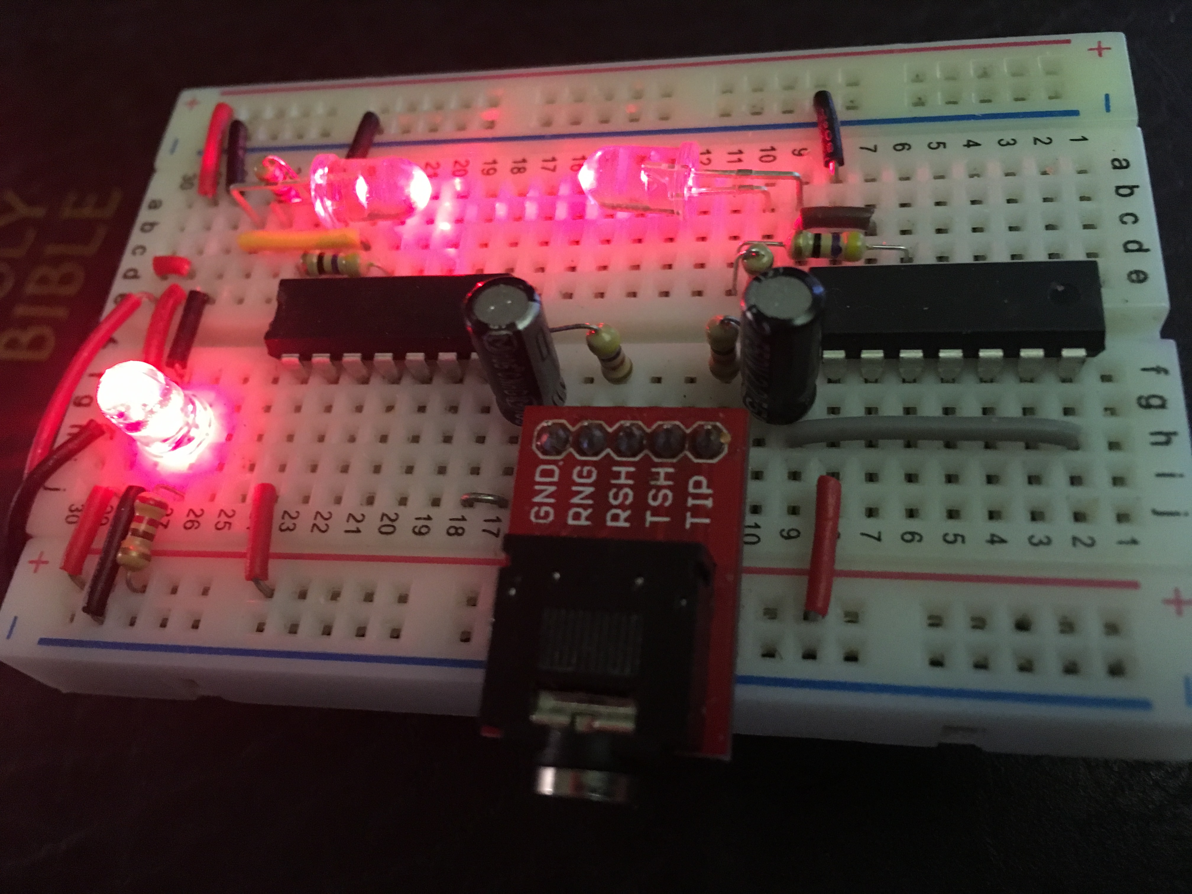

On my desk is a flickering red light - two of them actually. Two LEDs pointed at each other forming what is essentially a bidirectional optical interconnection node. It was last night's project and for a change I went slowly and patiently and it works just fine now.
What is it? It's a music maker based on an oscillating pair of LEDs. I'll get into the details in another post later in this thread, suffice to say it will become a simple and affordable little music source that NoodleDriver and I will open source for noncommercial use (contact us for permission to use commercially).
I envision a novel approach to audio done this way, with optical interconnect guided by light tubes. Again the idea is to make electronics easy - no soldering, no datasheets (or simple ones in their place), and an easy finger-safe way to hook things up that really dazzles!
So read on and I'll explain how it works. It's easy, you'll see!

OK! Time to divulge some secrets! Ears on, eyes open, and brain going kathunka-whir everyone, here goes something...
The biggest secret that I drew from the work of others to create this sort of audio rate optical interconnect may be found at this web page:
https://playground.arduino.cc/Learning/LEDSensor
There you can study - to whatever level of depth you wish - how to use an LED in reverse as a light sensor! Yeah, it's true: it's actually possible to detect light with an LED and all it takes is the LED, a 100 Ohm resistor, and two digital pins of an Arduino micro-controller. Of course we can use photodiodes or the more familiar CdS cell (LDR), but to get super low cost and bidirectional communication this is the trick.
If you study up on the example program provided on that page you will learn that the code first detects light with the LED in reverse bias, then drives emitted light out of the LED in forward bias. The duration of the driven light can be set proportional to the duration of the sensing with a simple change to the code, thus converting the detected light level into a time duration. Further, since the process repeats ad infinitum in a loop, this time duration becomes an audio rate frequency.
So what I did was make two of these devices and point their LED's at each other. The code involved is almost entirely the stock example code, plus a programmer code and an Arduino UNO board to act as programmer. Oh, and I almost forgot to mention that the micro-controller I'm using is an ATtiny84.
Any ATtiny chip will do I suppose, but the ATtiny84 is a 14 pin DIP chip so that there are 11 I/O pins. The smaller ATtiny85 is a dollar or so less expensive at $2 typical price, however it has only 5 (technically 6 but in typical use 5) pins. Either works well and there is a host of other ATTiny chips available.
So there you go, the ingredients of the special sauce for audio rate optical interconnect are yours now! Mix up a batch of wholesome goodness of your own today!

Hah! I had to laugh when I figured out this technique of landing a quadcopter, or a UFO for that matter, at night. Laugh, laugh if you wish - have a good laugh - but it's true and I'll show you how. But first a couple of photographs to get you up to speed with things.
I had trouble getting my images across the web from phone to computer, so they are a bit delayed. Attached you will find the Optical Oscillator photo. at the top of the image you see two red LEDs with leads bent and installed such that they face each other. These are attached to two chips. The chips are programmed to read a light level by putting the LEDs into reverse biased mode (photodiode mode), and then they are forward biased for an amount of time proportional to the measured brightness, thus converting the brightness into a frequency.
by placing these two in proximity of each other and facing together, they synch up and become an oscillator. Rotating one such that the light coupling is reduced causes the oscillation frequency to decrease. This makes for some fun with audio optics, and that is just one connection. Imagine now a panel of such devices, each with four or more LEDs all connected somehow... Such things are possible and even at a low price due to the ubiquitous (love that word) nature of the humble LED.
So get yourself some LEDs, some ATtiny84 chips, and have some fun!

Les, I learned a lot by reading your post. You are very creative and you're always thinking.

I believe there was a schematic in Elektor which used this effect, don't recall where or how, and there are a lot of projects in their 50-odd years of existence
I believe there are some other parts which can be abused to generate a photoelectric response, bipolar transistors? |
Joined: Nov 23, 2015 Posts: 1319 Location: Netherlands
Posted: Sun May 14, 2017 2:25 pm Post subject:
A nice little experiment:
Connect an LED to a probe of an oscilloscope and point the LED to the trace of the scope.
Watch the effect of photoelectric voltage produced bij the LED  |

Oh, how encouraging it is to read your responses! I've been working on this stuff for days now and I've had fun so far. It has also brought to focus some interesting observations. Like I work harder not smarter - gotta turn that around! I tend to have great ideas and spotty implementation at best, so there is definitely room for improvement.
I got the quadcopter thing t act "kind of" right. It's a qualified success though because of a limitation of the ATtiny libraries. They don't do threading (or at least the one I chose doesn't), so I have spent hours and hours wasted when I realize just now typing this out that I can use an UNO!
** correction: it is a Due that has threading, not an UNO **
Well, that is next - also the optical interconnect works great for control signals, but it's too slow for audio. That's good to know. Back to it!

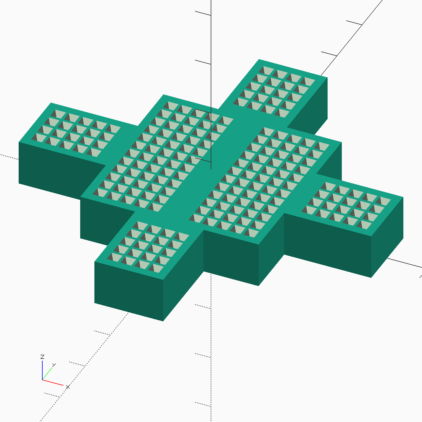

I've been making progress on my new emSynth project. It's the optical interconnect one. I've figured out how to make it do Fuzzy Logic which I studied just a little back in college. The concept is very simple and I can explain it in time.
the images below show a custom breadboard design that I'm working on at the moment. The concept is to resuse the internal clips from old breadboards, placing them into a new plastic shell. This idea has been on my mind for quite some time now and it feels good to actually put it into practice.
Once built (and I am printing the first one as I write this), I will insert the clips and make a few modules. Actually now that I've made this design, I am thinking of a simpler way to make it. the difference is whether the four wings are printed horizontally or vertically like the rest of the design.
In the case shown, the goal is to make an initial foray into the realm of a fully three-dimensional breadboard, say like one wrapped around a cylinder or whatever. So it's an experiment as much as a prototype. Far simpler, I now realize I could have made those wings just like the rest of the breadboard, simply oriented at 90 degree angles. I may make both designs for comparison purposes.
Or basically if the first design does not turn out well, I have a backup plan. Either way it's a simple way to prototpe a small system!
