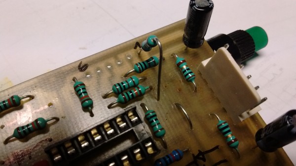

LFO1 (A):
A1 - Capacitor C8 is shown in schematics/BoM 1nF, but in component layout 47pF ?
A2 - C5 is in BoM 10nF, but in schematics/comp-layout 100nF (I decided 100nF)
A3 - R43 (47k) isn't listet in BoM (only on the bottom of it)
A4 - as I could't find an "old" wiring pic, I see no chance of "off-board mounting the R43 resistor, so my decision is a standing mounting with
one side in hole 1 and the other side in junction R32/34 (see pic below)
LFO2 (B):
B1 - Capacitor C8 is shown in schematics/BoM 1nF, but in component layout 47pF
B2 - C5 is in BOM 10nF, but in schematics/comp-layout 100nF (I decided 100nF)
B3 - R38 isn't in BoM, maybe mistake, because there is R39 (should be R38)
B4 - C7 is in schematics/BoM & new layout, but not in the old layout and latest wiring…should I leave it or try to place it ?
B5 - R10 is shown twice in schematics (at Sin/Tri sym and at PIN 3 of IC4)... should R10 at “SinTri” named R24 ?!
B6 - R18 is shown twice in schematics (right side at PIN 5 & 7) ...R18 at PIN 7 should it be there, because PIN 7 is not connected ?!
B7 - the second side of R43 is in "wiring" connect with "pulse", but not so in schematics: there R43 is on PIN8 (IC2c) & R41…what is right ?!
thanks for your patience
Gerd
 Filesize:  1.21 MB
 Viewed:  61 Time(s)

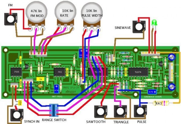

yusynth
Joined: Nov 24, 2005
Posts: 1314
PostPosted: Sun Jan 21, 2018 8:28 am    Post subject: Reply with quote  Mark this post and the followings unread
There the wiring diagrams as found on the site
 Filesize:  118.23 KB
 Viewed:  63 Time(s)
 Filesize:  88.68 KB
 Viewed:  68 Time(s)
Yves

A1: 47pF = B1
A2: 100nF =B2
A34: as i see it on ur foto u already have driiled a extra hole at the junction R32/34 - so why dont you drill a second one close to the base of the transistor?
or you could place it on on the solderside?
B3: R38 is in the old schematic one of the 10 Ohm Resistors
B4: C7 is not in the old schematic. if u dont have spikes in your (SAW) Waveform u dont need it - vice versa
B5: in the old schemo they are called r24 and r4
B6: R18 at pin7 could be there, it is the inverted SAW (Ramp) output, if u use it place the resistor there to protect the opamp out against shorting it to ground (also gegen nen Kurzen) this is most importand if u dont use banana
B7: in fact in the schemo it is connected to PULSE, but before the VoltageDivider, so the Base of the transistor would recive 15V pulses, may it is better to connect it like it is shown in the wiring
you could use any other output too, it would give you an other optical feedback, not just on or off, more fade in and out
