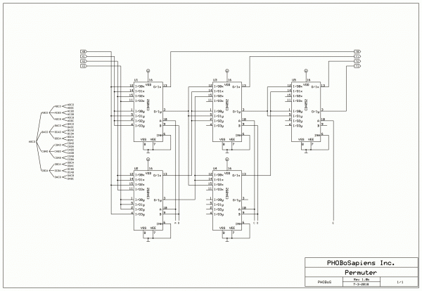

I already briefly mentioned this in the CMUSE thread, but what I would like is a circuit that has a
4 bit input and with some control signals can create permutations of these 4 bits (one at a time).
If you are unfamiliar with the term permutations it basically just means all the possible ways you
can rearrange the bits. I mainly want to test it with my chromatic melody generator but there are
other uses for it.
4bits has 4!=24 permutations. If the bits are labeled ABCD these are:
ABCD BACD CBAD DBCA
ABDC BADC CBDA DBAC
ACBD BCAD CABD DCBA
ACDB BCDA CADB DCAB
ADCB BDCA CDAB DACB
ADBC BDAC CDBA DABC
I have some ideas on how to achieve this but before I go into that I am curious if someone else can
come up with a nice solution. Using something like a PIC would be very easy btw but I'd like to do it
with logic chips. Although with something like a PIC it would be very simple to implement a CV input
and do all kinds of other things as well.
Instead of permutations it might also be useful to route an input to multiple outputs (like AABC or BDCD).
This would result in 4^4=256 different 'combinations'. A circuit for this would actually be very simple to
make. Just 4 muxes that route 1 of the inputs to 1 of the outputs controlled by 2 bits, so it would need 8
control bits in total.

It is easier to do this with DPDT relays. You set up a bunch of crossovers to gain all the permutations. Each round swaps (or not) a pair of bits. Have a look at Knuth's work on minimal sorting networks and then imagine each sorting node is a crossover controlled by a signal line. You can make a crossover in CMOS using 4053 chips but two chips yields 3 crossovers so you will need a lot of them.
You can cut down on the number of permutations you need by following you permuter with a barrel shifter type arrangement to generate permutations that are just rotations of other permutations. DABC is ABCD rotated right one step. Two 4052s should create a barrel shifter for 4 bits with 2 control lines.
Actually I think I would use 4052s - each pair of chips gets you 2 permutations and their combinations ... You would probably need 4 pairs with 8 control lines.
Steveg
Joined: Apr 23, 2015
Posts: 101
Location: Perth, Australia
PostPosted: Wed Mar 07, 2018 5:22 pm    Post subject: Reply with quote  Mark this post and the followings unread
Okay I've done the permutations, you need 3 pairs of 4052s with 6 control lines.
One wired as a barrel shifter.
One that swaps A<->B and C<->D
One that swaps A<->D and B<->C
Instead of the barrel shifter you could use one that swaps A<->C and B<->D you just get a different set of duplicates.

The ones marked with an ! are duplicates that already appear earlier in the table. As you know duplicates
are pretty much unavoidable as for 24 permutations you need at least 5bits (control lines) which gives you
32 permutations so 8 duplicates. The 4053 did indeed seem like a logical choice to do this. I will have a look
at Knuth's work, thanks for the tip.
yes, I thought about rotating bits and when I started thinking about it a couple years ago I actually drew up
a schematic. I didn't know it was called a barrel shifter untill now, so I called it a bit rotator. There is a downside
to it though. I didn't mention it but I would like to have it function asynchronous, so without the need
for a clock signal.
wikipedia mentioned a clock cycle but of course it doesn't need a clock. Another thing
I thought about is that half the permutations are mirrored versions, like ABCD & DCBA. So it is possible to
create 12 permutations, and then just swap all the bits to get the other 12.
I drew up a version with 2 pairs + 1 (which can be a 4052 or 4053) and 5 control lines. I translated it from the
tree structure on the left which I got after reading up a bit about how to create permutations. A nice thing
about is that it is rather recursive. To show this more clearly I also drew up a version with some unnecessary
connections. If you would do something like that in code you would put it in a loop and/or function. So just for
fun I also started on a schematic which does just that. It isn't practical, needs more chips and a Clock, but it's
a nice challenge.
Here are the schematics, the permuter ones aren't complete as they have some floating inputs and some pull
down resistors on the other inputs would be needed for a standalone version.
note: X0..X3 are the inputs, Y0..Y3 are the outputs, A..E are the control lines.
Thanks for thinking along Very Happy

I think starting with a barrel shifter is probably the easiest way to make it possible to do this with 2 control lines,
I also like the idea of using the fact that half of the permutations are mirrored versions so I want to make
that possible with 1 control line. Mirroring is of course swapping A<->D and B<->C.
You've already done both things, shifting and mirroring in this version :
However, I don't like the A<->B and C<->D step as I'd like to keep the same bit at the first place after the barrelshift and
only change it at the mirror stage. After a bit of puzling I think I figured it out. It does produce some duplicates of course
but it makes it very easy to use to shift bits or mirror them.
Rev1.1 uses 6x 4052 and is probably the easiest to understand. Because the last (mirroring) stage only uses half of U5 and U6
it makes it possible to add some extra options.
Rev1.2 makes use of this.
- When CTRL X = 0 and CTRL E = 0, all the outputs are 0
- When CTRL X = 0 and CTRL E = 1, the permuter is disabled and the outputs (Y0..Y3) are the same as the inputs (X0..X3)
- When CTRL X = 1, the permuter is enabled and CTRL E works as the mirror control input.
Rev1.3 works the same as Rev1.1 but with 2x CD4053 and only has 5 chips in total instead of 6.
I drew up a schematic for that too and went a bit insane typing out a logic table for it as well
It's too bad that although the 4052 has 2x 4<>1 muxes that they share the control inputs, otherwise
it could be done with only 2 chips. But it's also useful to add some status LEDs. If you construct the
whole thing like a matrix with the LEDs in a 4x4 grid you can instantly see how things are routed.
This is actually something I would like to do with the permuter as well but I haven't figured out yet
if there is an easy solution for this.
oh and if you're nuts you could of course use the 4051 (8x) and make an 8x8 matrix, which gives you
16777216 routing options. Or if you are completely bonkers you can use the 4067 (16x) which gives
you, well, I am not even going to type how many options that gives Laughing (it would also have 64 control lines)
edit: I noticed some (rather obvious) errors in the logic table, so uploaded a revised version.
 Filesize:  46.06 KB
 Viewed:  100 Time(s)
4x4 bit matrix logic table.txt
Download
 Filename:  4x4 bit matrix logic table.txt
 Filesize:  10.8 KB
 Downloaded:  89 Time(s)

here's the version with reduced chip count.

And then there where 6 chips left.
I don't think I can reduce it any further.
Just to be clear, this is meant to be used in combination with the 4x4 bit matrix
to give it the same functionality as permuter V1.1 & V1.3 but with LEDs.
