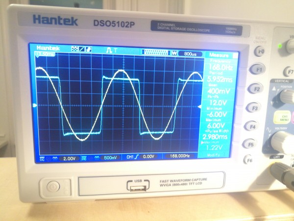

Hi, I'm debugging an MFOS dual VCA I've built on protoboard. It's really hard since I don't really know what to look for. I get surprised by some of the measurements but then again I've been surprised before with working circuits I don't fully understand.
So, one of the channels is completely dead on output. I've been focusing on the other one that at least has output, and when I have fixed that one I can A/B check on measure points to pin-point what's wrong with the first.
So, for the one that works, I have attached measurements. The attenauation seems to be working because I can control the amplitude quite fine on the linear side, but I only have a square wave on a sinus input:
So:
*channel 1 log - flatline
*channel 1 lin - flatline
*channel 2 log - flatline
*channel 2 lin - attenuation works, but the audio signal is turned into a square wave.
Any help on what to look for is highly appreciated. I've been poking around with my scope for hours, but simply have no clue.
* I have 0-250mV (turning the pot) going into U1-D's inverting output
* -10.5V to -1V going out of the same opamp (pin 14)
* after this is pushed against the negative rail, I have around -6 to -10V on the linear side of the switch. But only if floating, If I chose linear to connecto to the OTA pin 1, it's going down to -10.5 to -10V.
Anyway, this is for the "working" linear part of one of the VCA's that seem to do about right in the amplification part - I can turn the amplitude up and down with the pot. However, it turns the signal into a square Sad So there have to be something wroing in the very small OTA-part that I don't understand too…

I have a non-inverting input on pin 3 of the OTA which seem to do around 1.5V Pk-Pk. Is that too much?
Oh, yes it was. Love how posting question gives you the solution sometimes. TRIMA was turn way to far which made the difference on the inputs too big -> disting towards square. Sometimes I hate those multi turn trims because I'm too lazy to test the full range.

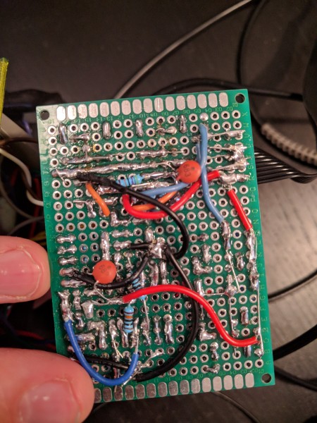

After much pain and relentless debugging I got it working. Yey!
I had done so many different errors when protoboarding this. I think my big lesson is to never ever protoboard anything this big on such a small board with so little planning.
I mean, look at this mess. I started out with no plan at all and just started placing components. Hubris.
I also burnt quite a few LM13700 - actually only one side of them and that was probably the reason why it took me so long to realise.
Just a list of stuff that I had done wrong as a reminder to myself:
1) debugging a broken LM13700 for ages
2) Not connected the 3904 base to the output of the first cv buffer.
3) mixed up channels when fallbacking to wires - the logA/linB on one side and logB/linA on the other for total confusion.
4) Wrong values for the 2K trimmers (was 20K). Not sure about that one, if I actually made that on purpose for now when trimming to have as little cv bleedtrhough as possible I actually hit ccw limit on them. Not sure yet if this is 2K or 0 ohms yet, but if 2K it would have been good with a higher value.
Actually I think I'm not going to protoboard much at all from now on. I've been building a few utils to be able to have a little more permanent breadboard modules and go straight from that to real pcb's. It's just to messy when trying to make things small too…
