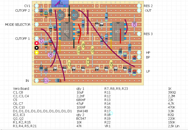

Hi Everyone !
I have made some stripboard adaptions of Yusynth modules (VCA/ADSR/Steiner Filter) and the Thomas Henry 555 VCO. As a big fan of stripboard, (many thanks to Minus for the 808 clone), I thought some of you might be interested.
That's my first stripboard designs so they are not optimized. But they are all tested and work fine. The Thomas Henry 555 is huge, it doesn't worth the effort now PCBs are back in stock. (BOM and Schematics : http://electro-music.com/forum/topic-54623.html)
Check the yusynth page, some components might be adjusted.
http://www.yusynth.net/Modular/index_en.html
I hope some of you will enjoy ! I think I will regularly add new stripboard versions.

Thanks for posting these, just more or less finished the adsr, after earlier finishing the steiner filer (which still can use some troubleshooting, threads with possible solutions for the minor flaws still experienced have been looked up through tfse Wink).
One thing I noted after initially experiencing some issues with the adsr though, is that orientation of the n4148 diodes can be best double checked with the original schematics, since the visual representation of their polarity seems to be exactly opposite between the 2 modules, and its hard to say in which one it could be called wrong.
