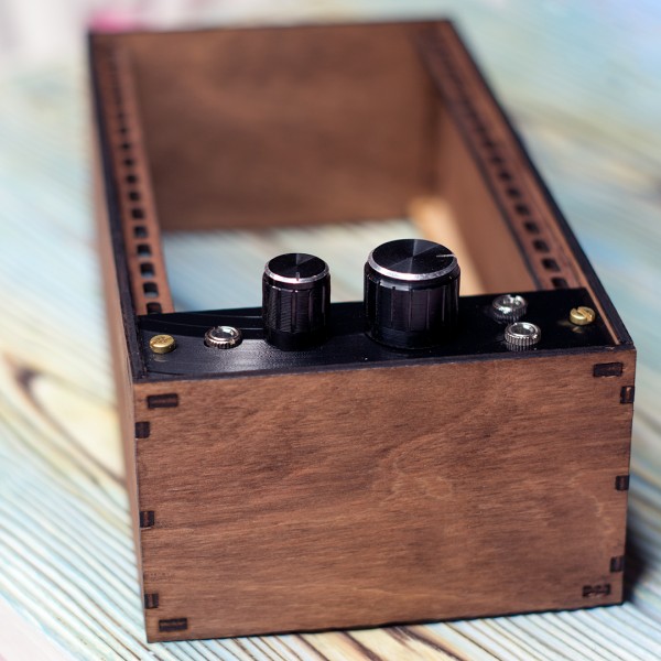

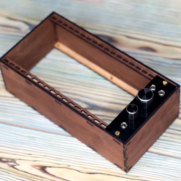

Eurorack case still is too expensive for me. So, I decided to make 'tiny' rack for testing new circuits for BassMaster. Height of modules is 100mm, width 10X mm.
 Filesize:  638.5 KB
 Viewed:  63 Time(s)
 Filesize:  722 KB
 Viewed:  65 Time(s)
