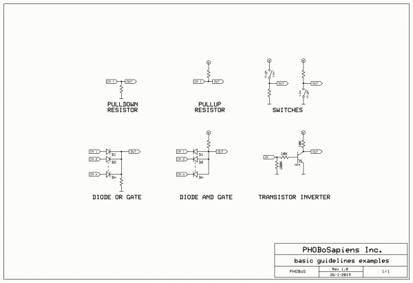

Here are some basic guidelines that might be useful if you want to design your own digital circuits. This is not an introduction into

When to use pulldown/pullup resistors
pulldown/pullup resistors are used whenever an input pin is connected to a signal but can stil end up in a floating state. An example
of this would be when you want to control an input with a switch. Let's say you have a switch between an input and V+. When this
switch is closed the input wil be high but when the switch is open the input would be floating. By also connecting a resistor to GND
to this input (= pulldown resistor) the input will be held low when the switch is open. You could also have a switch between the
input and GND in which case you would need to add a resistor connected to V+ (= pullup resistor). pullupdown/pullup resistors can
also be needed when using analog muxes/switches or chips with tri-state outputs as these can also cause a floating state. The choice
between a pullup or puldown resistor depends on the circuit.
note: the value for these resistors is usually not very critical and values between 10K~1M are most common
Diode OR/AND (mickey mouse logic)
Allthough diodes can serve several purposes they are often used in digital circuits to create simple logic gates to combine signals. You
could use actual OR/AND gates but using some diodes and a resistor can be much more convenient, especially when you need a gate
with a lot of inputs. To make an OR gate with diodes connect all the cathodes together, this will be the output. The anodes will be the
inputs. Whenever one or more of the inputs are high the output wil be high (like a standard OR gate) but if all the inputs are low the
output would be floating (the diodes block the current flow) so usually it also needs a pulldown resistor. To make an AND gate you
connect the anodes together, which will be the output and the cathodes will be the inputs. It's a bit less obvious than an OR gate but
when one of the signals is low (in other words they're not all high) the output will be low. However when all inputs are high the output
would be floating so in this case it needs a pullup resistor on the output. Because the outputs aren't buffererd this method can't always
be used. For example it gets a bit tricky when you would want to use a diode OR to control a diode AND or drive an LED. For this reason
it is also better to avoid using them as an output stage of a circuit, at least without an extra buffer for which a transistor/opamp/
comparator or even another logic gate could be used.
Note that you only need to use diodes for signals that can be both high and low. If for example you want to combine (OR) an output
of a logic gate with a switch connected to V+ you don't need a diode for the switch as it can never be low
Transistor inverter
As with the diode OR/AND gates you could use an actual inverting logic gate but sometimes a single transistor can be a lot more convenient.
Most commonly used is a standard NPN transistor (BC547, 2N3904 etc) with the Emitter connected to GND. The Collector will be the output
but since it can only provide a low signal in this configuration it also needs a pullup resistor. The base should have a current limiting resistor
in series and be treated as other inputs so not left floating. You could also use a PNP transistor connected to V+ and a pulldown resistor but
this is not used as often. One big advantage of a transistor over an actual logic gate is that it can be used to convert voltages. For example
controllling a logic circuit powered by 12V with 5V signals will usuallly not work but a transistor only needs about 0.7V on the base so 5V is
plenty and with a pullup resistor connected to 12V the output can now switch between GND and 12V with a much lower control voltage.

* (I might add some images later) *
edit: added some examples

PostPosted: Fri Feb 08, 2019 1:13 am    Post subject: Reply with quote  Mark this post and the followings unread
Phobos - is there an easy way to explain how the mickey mouse logic AND works? Can't seem to get my head round that one Confused
Posts: 4216
Audio files: 613
PostPosted: Fri Feb 08, 2019 3:33 am    Post subject: Reply with quote  Mark this post and the followings unread
That one can be a bit confusing as it requires you to look at it in a slightly different way. You're used to thinking that for an AND gate when all inputs are high
the output will be high
. For this mickey mouse logic AND it's easier to understand if you write that as when none of the inputs are low the output will be
high
. Or you could also say when (at least) one of the inputs is low the output will be low. Also the high output state is provided by the pullup resistor
and the low states through the diodes.
last but not least a truth table might help too (A/B are inputs, X is the output):
Code:
 B | A | X
 0 | 0 | 0
 0 | 1 | 0
 1 | 0 | 0
 1 | 1 | 1
