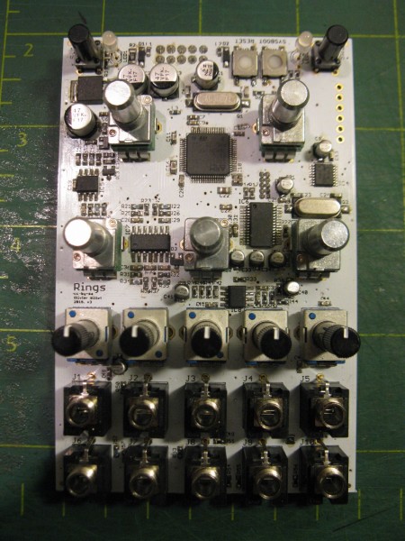

I finished another member of the Mutable Instruments family: Rings.
I did mess up soldering the ARM processor as some pins got bend sidweways. I think this happened with
the desoldering braid. Of course it went wrong on the last side I soldered so it wasn't easy to take it off.
Instead I spend about 2 hours trying to fix it which involved soldering a wire to one of the pins. That's when
you find out how small these pins really are. I had no idea if it would work so I only soldered on the parts
that were necessary for flashing the processor first. Since that went without any problems I had a bit of hope
and I soldered on the other parts. There was no smoke on powerup, as a matter of fact it actually worked! Very Happy
Today I finished the frontpanel which came out pretty nice so here it is.

That's when you find out how small these pins really are.
Heh.. looking at that last picture I thought .. wow .. those pots are huge ... but still miniature ones Cool
And I see you lost some beard hairs on it Wink
