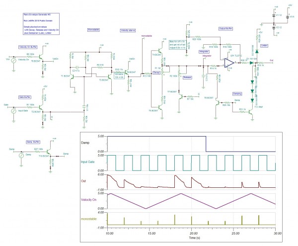

I have been playing with the circuit on the simulator today. It is an envelope generator for struck/plucked instruments (things that will ring until they die down) such as piano/clav/bass/cymbal. Plus it has a "second mode" that can be switched in for effects like open/closed high-hats, damped guitar picking, or harpsichord's "lute" stop.
It features multiple kinds of damping: Release. Decay, Dampen pedal, Limiting, friction damping.
The final circuit is small but a little dense, so I will present it as a series of 3 circuits of increasing complexity. There is a tweaked version for hihat at the end, too, with an interesting "soft note erasor" knob.
Here is the first. This just takes a gate and produces a decaying tone. There is a Decay time control. (Because log decays take forever, there is a diode drop on the output: this simulates how real instructions usually don't decay with a long tail due to friction etc.*)
The signal goes from left to right. You can see in the design there is a transistor buffer, a monostable multivibrator to give a clean trigger, then the integrator and output buffer.
* If you want a gong sound, however, you probably want a long release, and might prefer no diode drop: but, to a great extent, long releases are better done using reverb units: the Envelope Generator can pay more attention to the envelope behaviour at the note on and note off.

This version adds a Release time, when you release the gate. The Release time is always faster than the Decay. (There is no Attack or Sustain needed for these kind of envelopes.)
This version also allows accents, through the velocity input. (This should held to 5V if nothing is plugged into the velocity circuit.) The velocity accent works by making the monostable's pulse louder, down to nothing. You can see the pulse following the velocity input in the chart next.
This version also has an op-amp as the last buffer, to help with offset control.

This version adds a Dampen input. (Actually it can be continuous for a different effect, but its main function is to be gated, e.g. by a footswitch or LFO.)
Dampen is rather like the lute stop of a clavichord or harpsichord, or the dampen pedal on a piano, or the "all note off" MIDI function, or grabbing a cymbal: if there is a new note, it makes it very short and softer, if there is an existing note ringing or held it kills it. (Opps, the gate is upside down...) In the circuit, has three little parts: an input buffer for the Dampen input signal), a dampen circuit to deplete the capacitor no different to the Release mechanism, and a little diode chain clipping circuit enabled with the dampen that makes it softer.
I have made a tweaked version below of this circuit as a HiHat Envelope Generator, where the Damp input acts as hihat open/close.
The limiter effect is based on the observation that when you hit a piano fff and ffff there is no real difference in maximum volume, as the strings cannot vibrate more than their nature, but instead the extra energy changes the envelope shape, to be fatter. (Supposedly, this flat top is what makes the Minimoog EGs "fat"). You can see the effect in the Out trace in the first second (of time), where there is a little "roof" visible.
If I get round to it, I could add legato/Hold2 (turn off the G signal) and NotOff velocity (add a negative gate to offset the signal after R30.) But this seems enough.

What is the point of another EG design? I guess the thing that makes this EG different from many is that I am trying to model the operation of energy being transferred to a resonating object. So this perhaps gives the velocity (and so on) a different action.
You can see in the figure below, when the same gate time and Decay setting is used, but the velocity is different, the high velocity envelope is not only louder but it takes almost 20 seconds to complete.
But when the velocity is low, it is not only softer, but it also only takes 5 seconds to complete. This is different from, for example, a velocity system that only amplifies the eg but maintains the same time constants. (You could get a similar effect by variable biasing and half rectifying, I guess.)
