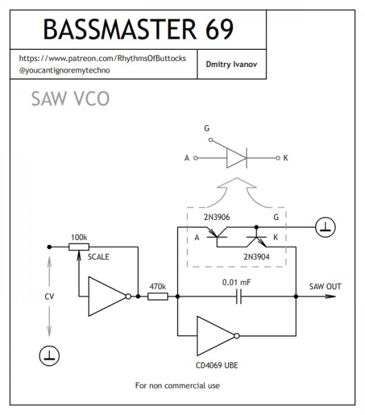

Here are some new circuits of BassMaster 69:
Dual power supply
 Filesize:  96.68 KB
 Viewed:  155 Time(s)
VCA
 Filesize:  112.59 KB
 Viewed:  148 Time(s)
Saw VCO
 Filesize:  104.49 KB
 Viewed:  151 Time(s)

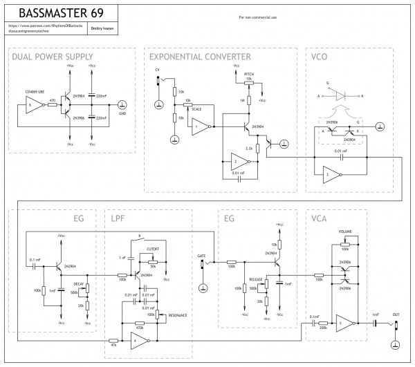

I got carried away with sodering... BassMaster 69 is fully analog, with CV/Gate interface.
Video:
BassMaster 69 circuit diagram
 Filesize:  434.29 KB
 Viewed:  162 Time(s)

Nicely simple electronics - I love that thyristor osc thing .. that must be about as simple as it can get Cool
nice tune too Wink
also .. please don't march .. we are on a bridge right now.

PostPosted: Wed Aug 22, 2018 2:14 pm    Post subject: Reply with quote  Mark this post and the followings unread
And it's incredibly stable!
BassMaster 74 will be modular. It's very hard to make all this on one small PCB.
