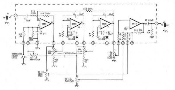

Help!
I'm looking for a bandpass filter where it is possible to shift the center frequency with one dual-potentiometer.
I know there must be some, but I cant fint them...
Power supply: +12volt, -12 volt
Center frequency: 300Hz - 3kHz

Why not a BP VCF like a state variable? Then you can have a pot (single) for Fc and another pot (also single) for Q. Then if you need to control it with voltages, you've got the inputs already there.

This might be just what I'm looking for...

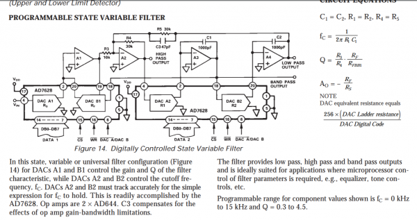

This times it is really hard to find a filter which is not voltage-controlled. And most of them are children of generic state-variable filters. Perhaps only guitarists are still using filters with potentiometers. Here is one of them (Anderton super tone control).
Instead of potentiometers people uses OTAs, FETs, DACs... to control filters by voltage or by Arduino Smile
Below are some examples of such filters if you change your mind about way of control [FET VCF from gasboss Smile].
Simplest to build but hardest to modulate are the state variable filters where resistors (potentiometers) were replaced by multiplying DACs.
[from the AD8684 datasheet]
[from the AD7628 datasheet]

MFOS State Variable Filter maybe? 12v -/+ with LP,BP,HP
I have this one on the bench, not completed just yet Twisted Evil
http://www.electro-music.com/forum/topic-53353.html
