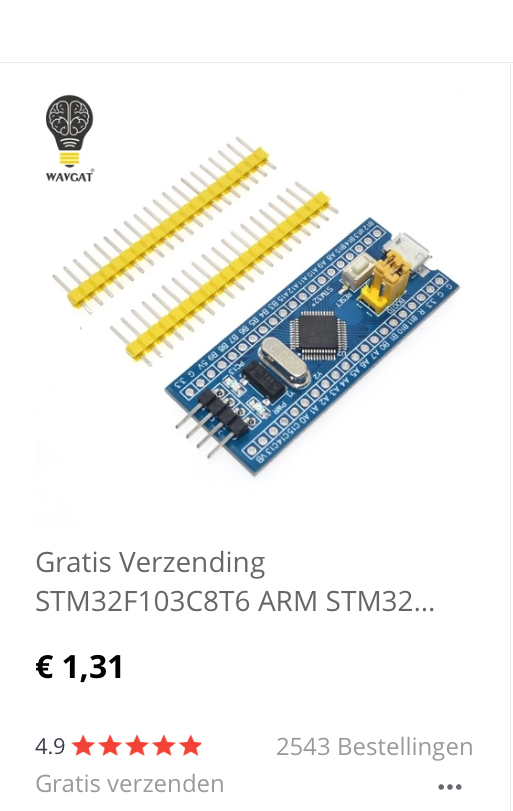

PostPosted: Thu Dec 20, 2018 5:51 am    Post subject: Reply with quote  Mark this post and the followings unread
Seen it on Alieexpress, is it compatible with the Arduino ide or just the pinout?
Delivery free of charge.
Any schematics at hand?
 Filesize:  172.97 KB
 Viewed:  593 Time(s)
