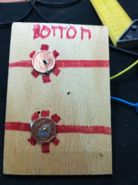

/* two cents start */
the basic idea was to solder some coins on top of each other to get a socket (pic1)
for the matrix you now could imagine a two-sided PCB where you have solderpoints for the coins on each side, one side vertical, other side horizontal connected
if you then plug a banana plug, you have a connection, right?
i would expect that some offset disances here and there are needed
maybe the use of two PCB on top of each other to give it more strength?
/* two cents end*/

cslammy
Joined: Apr 27, 2018
Posts: 151
Location: USA
PostPosted: Thu Dec 20, 2018 9:56 am    Post subject: Reply with quote  Mark this post and the followings unread
Interesting g.gabba as always. Coins eh? You always have good ideas! Very Happy
I am going to mess with this in different ways. I understand that the Ghielmetti matrix costs a fortune (hundreds of dollars?) if you can find it at all....which I can't. So I'll see if I can some up w/ something DIY. If I come up with anything that sorta works I will write it up on the blog.

Still working on this. I am now on the 3rd revision of the patcher PCB, still can't come up with something I like.
Fellow e-m member mvcl turned me on to MUX506 by TI, that's the next thing I'll try...http://www.ti.com/product/MUX506. Sounds like a very useful chip for Audio DIY.
bipolar (!) 16 input (!!) sort of version of the 4051.
Also, I have a cheap putney patcher working. Not sure of how durable it is but for this project it'll probably work! I'll do a blog post about that.

Thanks. Luck pays off? I have a prototype working.
http://audiodiwhy.blogspot.com/2019/08/putney-poor-mans-patcher.html
