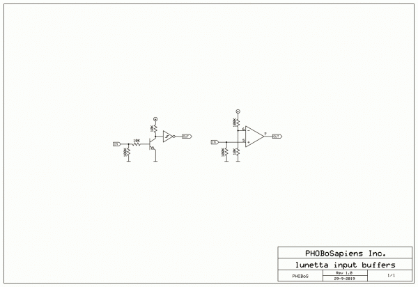

Anyone out there have any solutions to this?
Running a CD4015 4 BIT Shift Register on +12V / Ground, it's Data In will not accept incoming data from, so far:
- Bastl Knit Rider step output, as a Trigger or a Gate. (+5V)
- Ladik S-180 Gate Sequencer. (I DOES with my Euro to Lunetta level converter. The above Bastl, does not, either.)
- Delptronics Trigger Man - only, with it sent through a 4ms RCD in Gate mode. 1ms or 10ms outputs from the Delp., made no difference.
Now - I'm going to go and look at the Datasheet for the 4015 to see if I can make out what the Clock / Data inputs are expecting Voltage wise at what length of time.
So far for me though, it's quite the set of puzzles to figure this one out. :-/
Any help appreciated.
Ryk

PostPosted: Sun Sep 29, 2019 4:46 am    Post subject: Never mind ... found help elsewhere. Reply with quote  Mark this post and the followings unread
The 4015 is expecting incoming data to be at least 0.7 x Vsupply. The Bastl Knit Rider is only spitting out +5V. Solution? Amplify it.

PostPosted: Sun Sep 29, 2019 6:28 am    Post subject: Reply with quote  Mark this post and the followings unread
That would have been my guess. Most CMOS chips like a high voltage level close to the supply voltage, the 4017 in particular
can be a little bitch about it. When using external control signal I like using a transistor + schmitt trigger combo or an opamp
configured as a comparator. The latter one is especially useful when interacting with modular synths although it could benefit
from some added hysteresis.

PostPosted: Tue Oct 01, 2019 5:43 am    Post subject: Reply with quote  Mark this post and the followings unread
Thank you sir! From Lunetta'ing a few years ago, I found 2 x 'General purpose' chip PCBs that I'd used for the 4024 counter. (Scrapped.) I'm going to re-purpose one of them for the Schmidt and the other for a quad NAND. Miss having that. Years ago I had a panel with 8 x NANDs and 8 x XORs. Lots of wonderment came out of patches using that panel as well! Very Happy

PostPosted: Sat Oct 05, 2019 10:12 am    Post subject: Reply with quote  Mark this post and the followings unread
I just sorted that very same problem while trying to breadboard one of your 555 AD/AR's, PHOBoS... running it at 9V seemed to give better attack and decay/release times, but I was trying to trigger it off 5V. Used the transistor circuit you posted (which I had nicked off your lunetta keyboard thread) and it worked like a charm!
