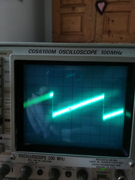

Hey,
I'm currently trying to build a VCA with an AS3330. I build one of the VCAs according to the datasheet. As i powered the circuit, i saw, that the output signal was weaker as i expected and that this annoying high frequency noise in it.(ass seen on the image). Input was a 5V AC-coupled sawtooth.
I tried multiple things: adding a filter to pin 7 like in the original CEM3330 Datasheet, tying the inputs of the other VCA to ground with resistors, adding many capacitors on the supply.(as seen on the image) But all of this didn't work.
Does anyone have an idea?
Best regards,
Franz Smile

Did you use a proper ground for your scope?
That was my first thought too. Looks like bad grounding, which happens a lot on breadboard circuits with scope probes flying about all over the place.
Yes, i tripple-checked that already. Sad

Total guess: if you stripboarded or created a PCB your issue might go away?
I frequently have trouble with grounding, unwanted resistance, cap coupling that doesn't quite work, etc., on breadboards. Maybe because until recently I used a $3 banggood breadboard?
An EE told me when breadboarding always buy a really good bread board (3M for instance, which is expensive) even though I'm tempted to buy the cheapest thing I can find. He says: If the part isn't really nailed in there, and the cheap ones are a bit loosey goosey, you can have all sorts of issues. The 3M ones tend to have more positive contacts.
I did this and have had somewhat better results. Of course this could not be your issue at all.....

+1 on what cslammy said. I spent some cash on a breadboard system and it was well worth it.
Quality of the breadboard is important, but also pay attention to the conductors you insert. I've had parts not work or not work correctly due to dirt, grease, oil or corrosion on pins or leads.
This sounds pretty logical to me, since the circuit worked for 5 minutes but then gave up again. And my breadboard is indeed a pretty cheap one, thats for sure. Laughing
I just finished a PCB Design utilizing the AS3330 and two AS3310s, i might get them done until next week.
