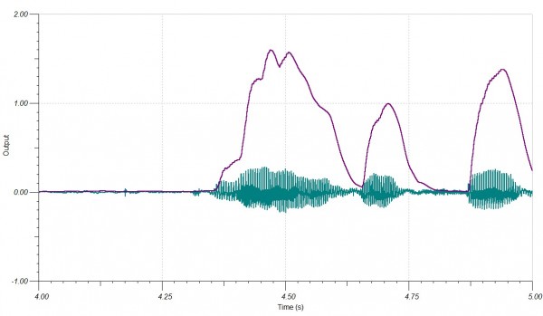

Simulation. This is some speech. you can see the front is eager. Smoothing is set to maximum, so there is some smear/delay.

the scope shot looks good so I think it is a success. you can challenge yourself to make it simpler without losing performance.

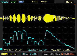

I have built this circuit and it does indeed have a fast response and a low ripple, and for some circumstances it would be very useful, but it comes at a cost of significantly increased complexity, and the need to tune the sampling clock to the frequency of the audio sample. for some situations this would be fine, but I'm not so sure about being super for my use.
I am trying to capture very low frequencies to the low audio threshold and at that rate we certainyl see some significant stepping. I also got some bleed through of the clock - although that is potentially a breadboard issue, plus the fact that I, um, didn' put any power decoupling caps on the breadboard...
I would say its main advantage is very fast decays matching the audio way better than a capacitor can manage without significant ripple, so in that sense I certainly agree that it is a faster and lower ripple EF.
I took some scope shots, but obviously I can't show the input and both out puts at once so you'll have to do a bit of to and fro-ing and
probably I will now actually build the top schematic and compare them all!

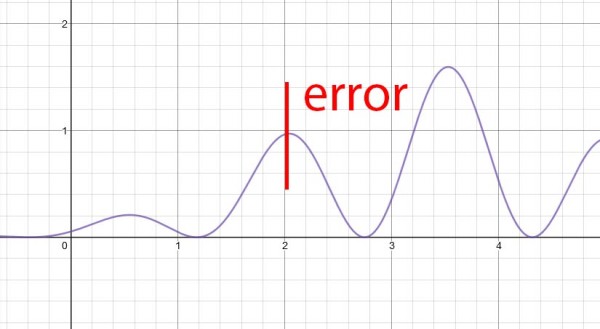

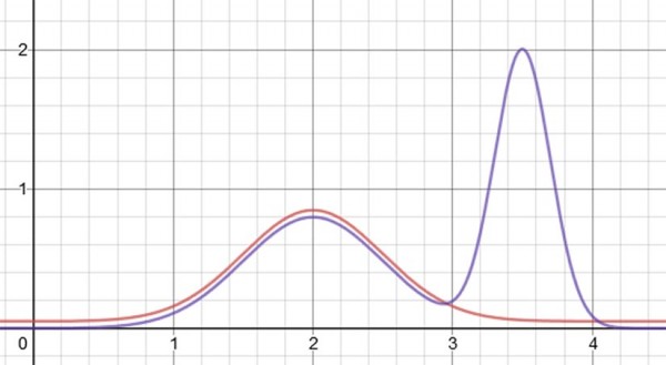

building a circuit or writing software to detect the loudest part of an incomplete data set while it is in transmission has always been a game of probability and never scientific certainty. in digital systems you could say that the loudest part is binary 1111111111111111. but your chances of getting that at the DAC without clipping is close to 1/inf. (actually probably more like (1/(2^16))/(2^17)).
I made a picture to show that the data that has been processed could potentially be useless in preventing all false positives for largest peak detection. what comes down the wire after you detected a peak could be a real retraction or it could be the real peak you were looking for. there is no %100 perfect solution to this math problem. this is why all envelope followers that include a gate output have an adjustable threshold. you are really bullshitting yourself if you think you have a way to predict the future without already doing look ahead of the entire audio file that you want to extract peaks from.
what you will probably do, since I already see how you think, is build a circuit that will work best at one program level with one kind of music consistently hitting some average of peaks per second based on your calibration. this is not what you claim to be building. a machine that can always detect the loudest part of an incomplete signal by measuring an arbitrary amount of retraction over an arbitrary amount of time without knowing the program level or peak level. bottom line, your envelope follower will require audio to be loud enough to match your calibration. this is not a universal machine. it is a primitive rule based machine. the suggested designs are complicated filter networks that pretty much self calibrate like an automatic gain controller. not a perfect system but better than building a machine that labels all retractions as peaks.
