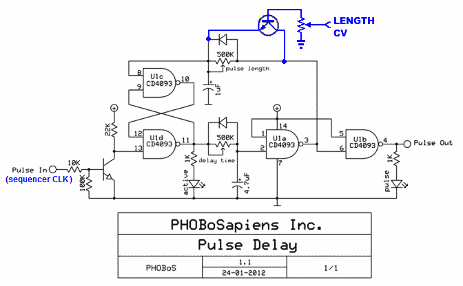

It's not exactly what you're looking for, but this Pulse Delay might be helpful.

It's not exactly what you're looking for...
but it can be!
If pulse in comes from the sequencer's clk (active hi) then each step will have a duration set by the length pot. Make that voltage controlled by a separate rank of pots and each step can have a different duration.
Do the same for Delay (with yet another row of pots!) and each step can have variable "swing"!
One hang up might be if duration or delay are longer than the time between clk pulses. The caps shown might need to be smaller for faster sequences.
Edit: corrected terminology; syncopation-->swing

You could do this with a monostable circuit.
That's what Phobos' circuit is. I suggested voltage controlling the duration.

ah, I wasn't even thinking about Voltage Control. though rereading the question that was probably implied.
The transistor thing will most likely work, good idea Very Happy

Ah, I didn't look closely. I've built a few transistor monostable circuits, and they work pretty well. I haven't tried voltage control over the length though, just manual.

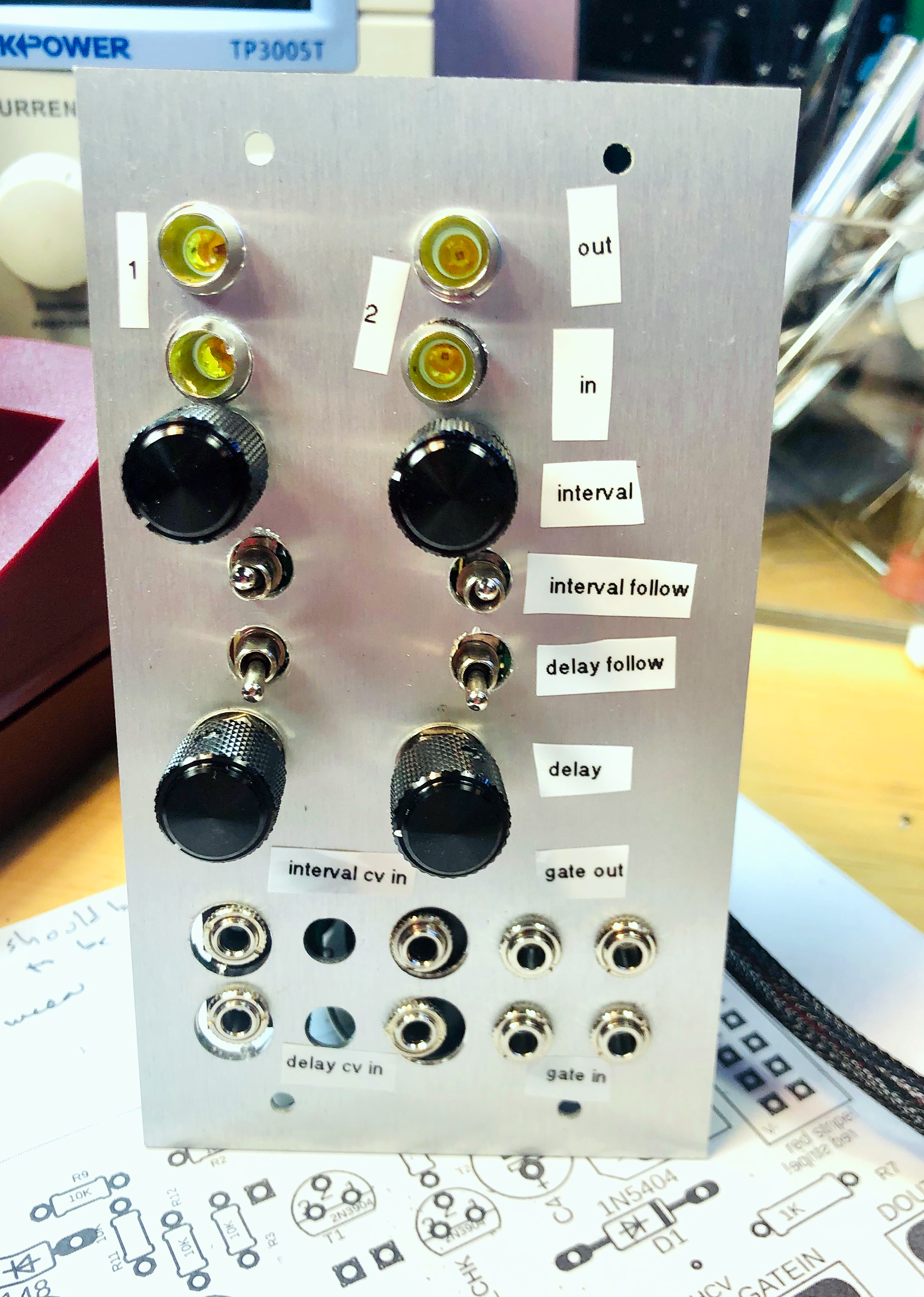

Hey there, I've built this same thing but using Arduino Pro Mini clones.
Using arduino, easy to get control of delay, gate length (controllable via pot or CV) as well as switches to ignore gate-off or not. Pretty low parts count.
https://audiodiwhy.blogspot.com/2019/12/gate-delay-part-iii-works.html
