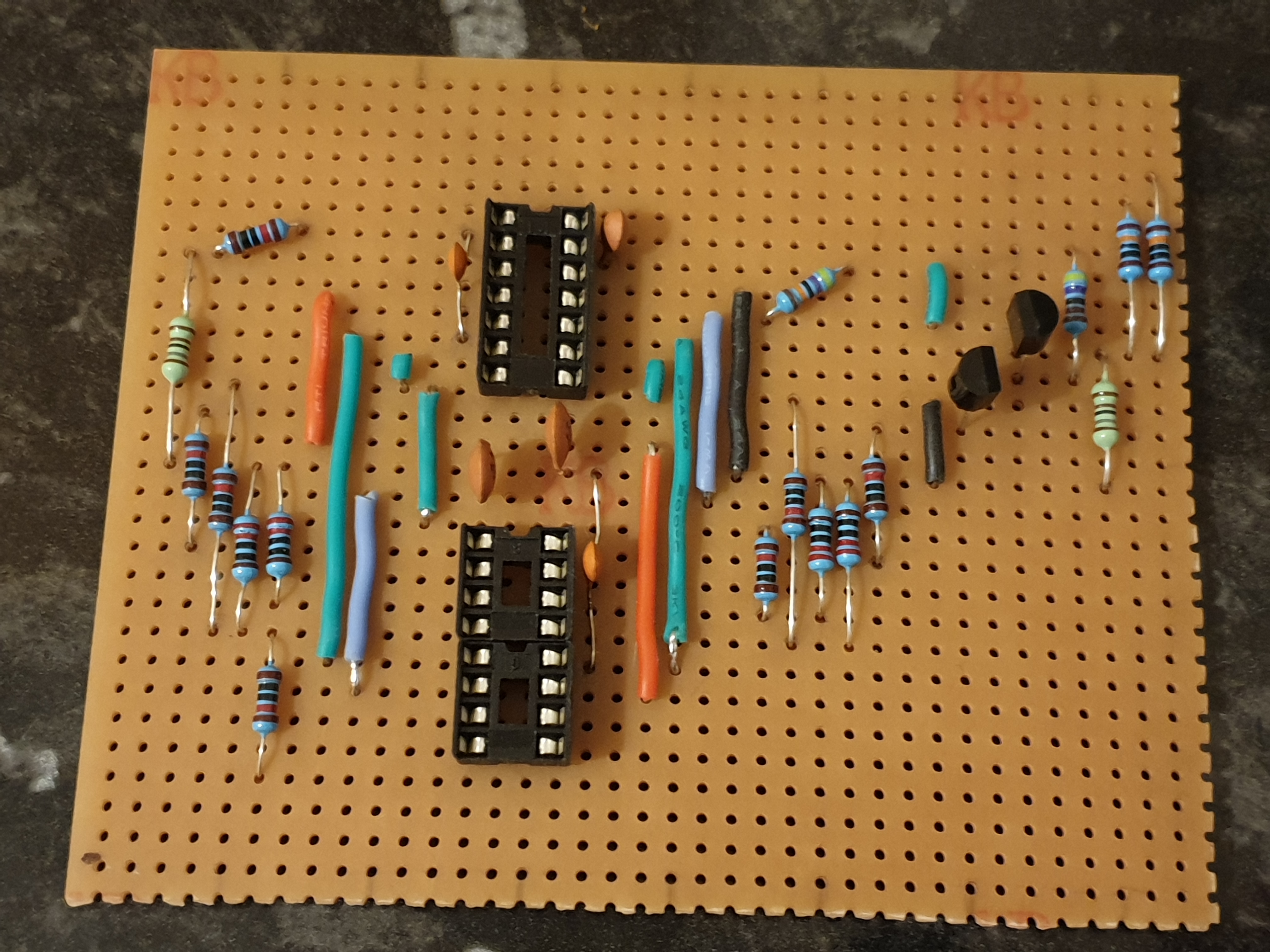

I have a few questions about the MS20 VCF layout by look mum no computer.
https://www.lookmumnocomputer.com/projects#/simple-filter
I am not bothered about the LEDs, could I just use diodes.
I assume the answer to that is of course you can you crazy fool, an LED is a diode Rolling Eyes
BUT which ones would I be best using ?? are they LEDs rather that diodes for a reason and it won't sound as good???

Hey, yes you could do it, but instead of 1 silicon diode per LED I would recommend using 3 in series. The two LEDs are limiting (soft clipping) the feedback/resonance signal depending on their forward voltage. The LEDs have a forward voltage drop of about 2.2V. In order to get similar performance you can replace them with the 3 silicon diodes in series who have a forward voltage drop of about 0.65V (0.65V * 3 = 1.95V).

The LEDs are for limiting resonance, they won´t light up! Very Happy

I've decided to use them anyway to be on the safe side, but I'm not going to mount them on the panel (especially not if they don't light up Very Happy Very Happy ... although I'm sure they did on the look mum no computer video he did ?? )
I haven't quite finished it yet as I am struggling to source some of the parts, well I say some of them. 1 of them, the 470nf cap.. it says ceramic I can find MLCC (multi layer ceramic capacitor) , I assume these are ok ??

Just about finished this little beauty now, just waiting for my 470nf cap to arrive and my LEDs.. yep I had no LEDs at all.. no I couldn't believe it either I thought I had loads ???? Odd..
Can't wait to finish it now just hope it works..

My LEDS are lighting up when the resonance is fully open. I used green LEDS.

yeah I finished mine and mine light up too Smile I am thinking off adding them to the panel after all Very Happy
just on another note, I asked in this post about using 470nf multi layer ceramic caps if they were ok... I tried one and it didn't seem to work properly so not using a cap at all there at the mo and it sounds awesome ...
