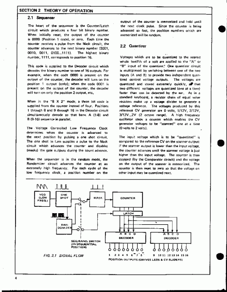

Why not make the Arp 1601 quantizer?It is the industry standard,if not the only true commercial example.Can't be too expensive given the time of manufacture.
I have the service manual pdf. somewhere in the vaults....if you need?

PostPosted: Mon Sep 04, 2006 5:15 pm    Post subject: Reply with quote  Mark this post and the followings unread
If they're blacked out they should enlarge to be readable,some sort of gif dilemma i'm unsolved on.......
Robert

Thank you! I had actually thought about the method described, but if you want more than 2 octaves it gets quite unefficient.
Someone in a german electronics forum suggested using an ADC0808 8Bit converter chip. costs 80cents.
What do you think about that?
Another solution for generating a stairvoltage would be to use a Binary counter like a 74HC4040 with resistors on the outputs: Q5 R, Q4 2R, Q3 4R, Q2 8R, Q1 16R und Q0 32R.
Do you think it´s a good solution?
