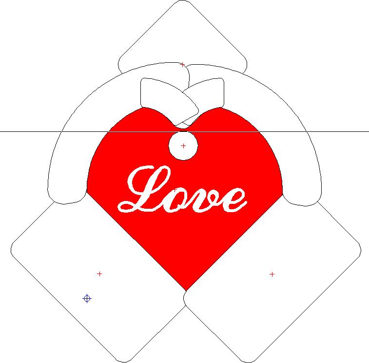

PostPosted: Fri Jan 25, 2008 2:05 pm    Post subject: Reply with quote  Mark this post and the followings unread
I know the content of the file is off-topic, but it's an example that you can make things other than front panels with FPE Smile
vday.fpd

PostPosted: Fri Jan 25, 2008 2:10 pm    Post subject: Reply with quote  Mark this post and the followings unread
Jeez! That's tacky! Shocked Laughing

factus10
Joined: Jun 20, 2007
Posts: 158
Location: Buffalo, NY
PostPosted: Fri Jan 25, 2008 2:14 pm    Post subject: Reply with quote  Mark this post and the followings unread
lol! you've ruined the surprise Wink
yea, it's probably tacky. Don't tell my girlfriend Smile
Someone at FPE thought it was nice. Fair warning, though: b/c there are cuts on all sides, there's a special machining charge ($15).

PostPosted: Fri Jan 25, 2008 4:47 pm    Post subject: Reply with quote  Mark this post and the followings unread
All I'm saying is that particular holiday is coming up. And what says more than "I made a gift for you the same way I make my modular panels?" Laughing
Btw, the preview they sent me looks pretty good... they fixed up my curves for me. Granted, it also looks like a tag you get for your dog at the pet store. But that's only b/c it doesn't have the white infill color yet Laughing
