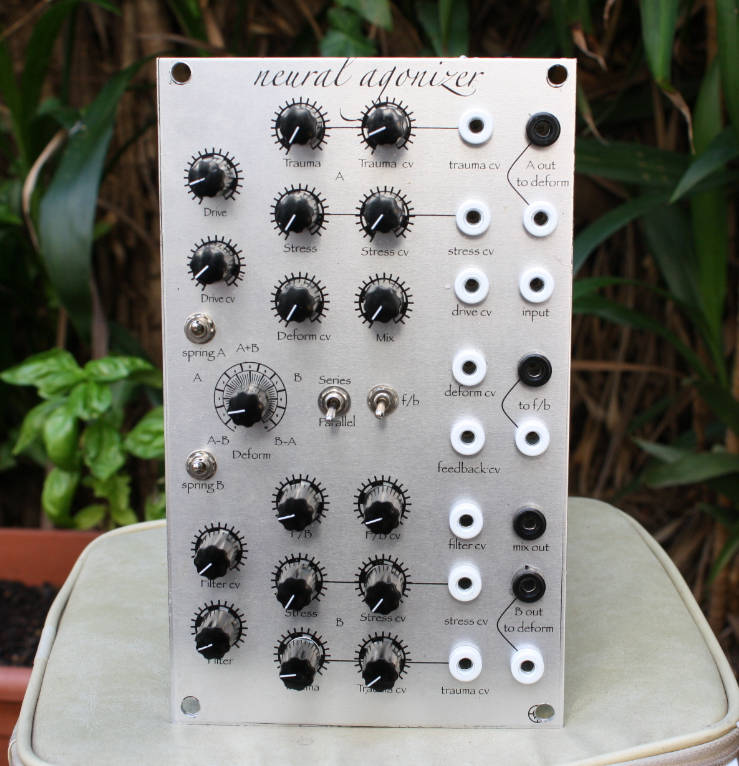

Luka
Joined: Jun 29, 2007
Posts: 1003
Location: Melb.
PostPosted: Sat Apr 17, 2010 6:57 pm    Post subject: Reply with quote  Mark this post and the followings unread
the module fits, no room for tanks
i didnt really think about fitting large tanks in my case when i built it
only enough room for modules and power (and only just for power)
yup i will make a external box for my tanks
im just working out the optium length for cables at the moment
dont want to make them too long
i have the 9FB2D1B tanks
problemchild
melbourne australia

Location: USA
PostPosted: Sat Apr 17, 2010 8:24 pm    Post subject: Reply with quote  Mark this post and the followings unread
Hi Luka, I'm sorry, I forgot that you arranged the group buy for those tanks. That was an awesome thing. Too bad I missed out. Sad
I think your front panel looks fantastic. I'm stuck in the MOTM format. I like the large format of it (more room for my fat fingers Wink), but I have to admit that I'm envious of creative panel graphics such as yours.
So, even though they don't fit in your cabinet, have you hooked up your tanks to see how your agonizer sounds?
