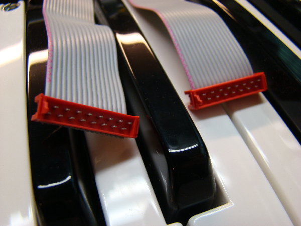

Posts: 2766
PostPosted: Wed Mar 03, 2010 6:20 am    Post subject: Reply with quote  Mark this post and the followings unread
I do have an adapter board that I have designed to make it a snap to interface to the Fatar keyboard assemblies. The attached picture shows this assembly.
Bill
