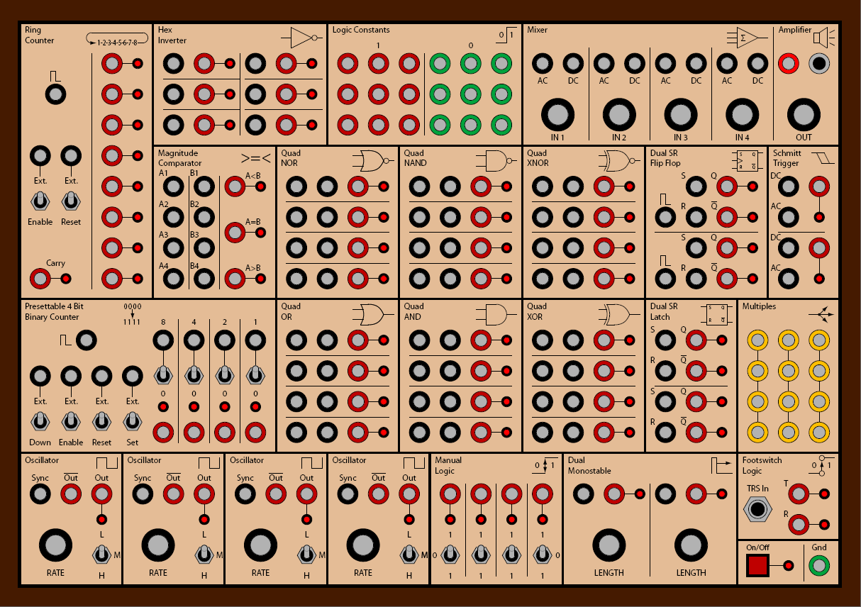

Here's my lunetta layout - I'm in the process of making the panel in bakelite but it's real bastard to drill so progress is slow.

PostPosted: Thu Feb 19, 2009 4:07 pm    Post subject: Reply with quote  Mark this post and the followings unread
You've earned a standing ovation from me for that layout!
I can't wait to see it ready to go. Please do a build progress!

PostPosted: Thu Feb 19, 2009 7:07 pm    Post subject: Reply with quote  Mark this post and the followings unread
wow thats awesome!!! now i feel like my jam packed design needs some of the cool stuff you have. i have a acouple questions?
1. what is the dual monostable design?
2.the manual logic, is it constant 1 or 0?
3.the logic constants are these similar to the manual logic but the red ones output a 1 and the green output a 0?
4.what ic are you using for the magnitude comparator.
5. and are you using banana's? im guessing no cause you have the multiples.
well it looks great cant wait to see more i second the build report!!

PostPosted: Thu Feb 19, 2009 7:47 pm    Post subject: Reply with quote  Mark this post and the followings unread
Thanks for the compliments guys.
To answer your questions scriptstyle:
The dual monostable is just that: two monostable mulitvibrators or one shots. They work just like gate/trigger delays or gate extenders in a modular synth.
The manual logic module is just a set of 3 position toggle switches that can set logical levels. Up = 1, Centre = 0 and Down = 1 but is momentary.
The logic constants work exactly as you guessed, red = 1, green = 0.
I haven't built the magnitude comparator yet but I was planning on using the 4063.
I am using banana jacks but I dislike the stacking function as they stick out too far when stacked and I find the stackable plugs to be too bulky for use where the jacks densely packed.
Adam-V
