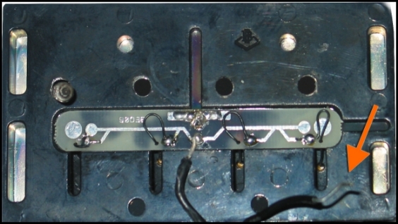

This is a follow up to my previous review. I was playing a gig and suddenly the bass developed a HUGE hum during the first set. It went away but as I was waiting to go back on at the end of the night (it was a one day mini-festival and the act was opening and closing) I was jamming backstage and the hum returned big time, but intermittently. I ended up using my Precision for the last set.
As I had to fly out to Goulburn for the Australian Blues Festival a couple of days later, and I can't trust any of the local so-called repair people to respond in a timely manner to what was an emergency for me, I decided to do some trouble-shooting myself
Obviously it was a grounding issue so I decided to start at the bridge - voila! This bass has a problem with it obviousy being designed to be slung together quickly by unskilled labour. The ground wire comes out of a hole drilled in the body between the electronics cavity and the bridge then the bridge is just clamped down on top of the wire. After a time, the wire presses a little indent into the body wood, becomes loose, and contact between the bridge and the ground wire becomes intermittent.
Easily fixed by someone with some basic electronics skills (like me), but not something which should be an issue on a nearly new instrument, and I can see it being a major unnecessary panic situation for someone electronically-challenged who has to run off to the repair dude for every little hiccup.
Now finding someone with more skills then I have concerning electronics...

Yes, the 'hum' due to bad grounding is gone. Now the bad A string sound is the next chapter. The URL you send me last monday was right about the strange wire underneath the pick-up. I took pictures, but aren't able to upload these yet, so maybe tomorrow.
I made contact with the distributor about the A string to check what replacements they still have in stock. First I will replace the string, because it's a bad one: no flagiolette possible, so it's an option (Jan disagrees Smile
Then I'll start replacing the pick-up elements.

Here are some pictures how Jan and I get rid of the hum.
The pictures show the bottom side of the comb. The red arrow indicates the loose wire which is clamped between the under side of the comb, which is made out of metal, and the body of the guitar. The screw in the left upper corner is underneath the E string and could not be removed without disturbing the saddle settings of the comb, so we left it in the hole...
The solution...
The wire is soldered to a little ring around the second screw, so grounding is fixed.
Bringing the wire in contact with the mixing strip of the print will mute the instrument completely, so using some tape and a plastic isolation strip could prevent an unwanted connection.
Wout
(who wrote this, but Jan did it Smile)

This "little ring", where did you get it? I needed such an object, well six of them, for my guitar modification. So I made them out of tuna can lids. I would like to find a source of where to get them. Any ideas?
Blue Hell
Posts: 22428
Audio files: 216
G2 patch files: 319
PostPosted: Tue Jan 06, 2009 2:46 pm    Post subject: Reply with quote  Mark this post and the followings unread
From a pile of stuff I could never throw away Wink
It's a a solder lug from an RCA type socket, googling for "solder lug" will find you some.
Wout Blommers
Joined: Sep 07, 2003
Posts: 4521
Audio files: 123
G2 patch files: 12
PostPosted: Tue Jan 06, 2009 2:49 pm    Post subject: Reply with quote  Mark this post and the followings unread
They were used to ground the chasis of a turn table to the chasis of the amplifier, so I think any radio shack should still sell these...
They were attached to a screw at the back.
