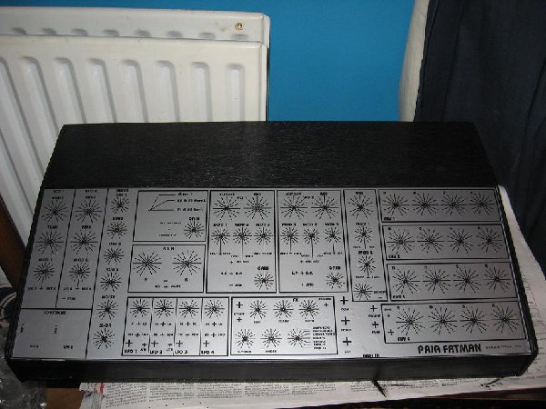

Hello, next project beckons Smile ,
Reworking my fatman to a more condensed case to make room for AMS2 synth due to build after summer.
Mod's used this time on the Fatman synth....
2 sub osc's.
ring mod.
2nd vcf.
bass boost.
3 more adsr's.
osc sync.
4 lfo's
Panel done in corel draw 12 saved as jpeg
i'll post some pics & sounds when done.

construction is flying on with this one , hope to have the guts transplanted from vers. 4 to newly stickered vers. 5 by this weekend.
4 Lfo's and 2 sub osc's to build on vero board then it's wiring time again..
a few bubbles to flatten out then the pots & switches get fitted

Fab, finished the fatman housing transfer, i've been getting some great bass line sounds since doing 2 sub osc's & X-OR ring mod, the last version had 12 lfo's , parametric eq and a crackly pwm,
all been thined down to a smaller unit ,with the features up above , freeing up much needed space Very Happy . here's a few pics of before and after and some sounds from the new build.....
